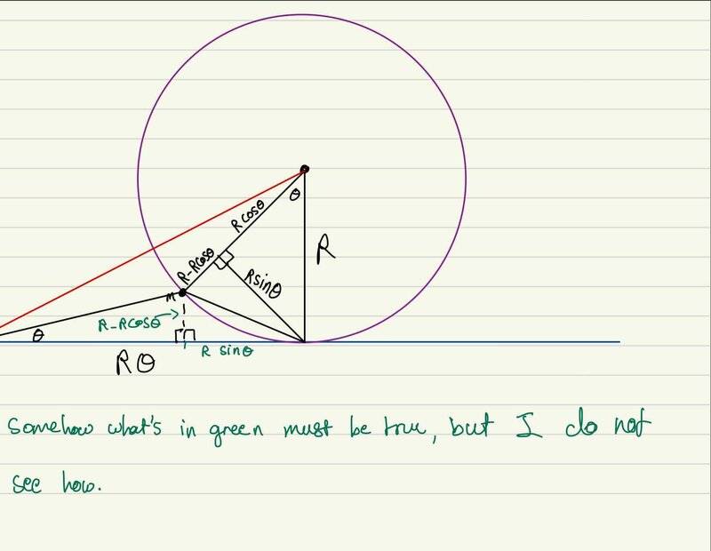

My issue is in deriving the coordinates of a point on a wheel that rotates without slipping. In Morin's solution he says that:
My attempt at rederiving his equation:
I do not understand how the triangle on the bottom with sides indicated in green is the same as the triangle on top that is the only way I can get morin's solution. Am I missing something? This doesn't seem like a trivial thing (unless I am approaching it incorrectly and there is an easier way of seeing it).

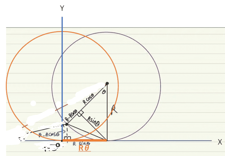

Please find attached the figure I draw on your sketch, which I interpreted from the text. The circle in orange rolls on x axis to become the circle in purple.
https://www.physicsforums.com/attachments/320402
The easy way to derive the EoM is to forget Morin's triangles and do it in two quick steps.
(a) Write an equation for a point on the rim in a frame of reference moving at the same velocity ##\vec v## with the wheel. Taking the origin of coordinates to be at the point of contact at ##t=0##,
##y=R(1- \cos\omega t)~##;##~~x=-R\sin \omega t##.
(b) Transform to the rest frame of the surface on which the wheel is rolling by adding ##vt## in the direction of motion. Then the position vector of the point of interest is
##\vec r= v t~\hat x -R\sin \omega t~\hat x+R(1- \cos\omega t)~\hat y.##
With ##\theta =\omega t## and ##v=\omega R## for rolling without slipping, one gets
$$\vec r=R \theta~\hat x -R\sin \theta~\hat x+R(1- \cos\theta)~\hat y= R(1-\sin\theta)~\hat x+R(1- \cos\theta)~\hat y$$which is Morin's expression. I find this method straightforward and easy to derive whenever needed.
Label the points
O centre of circle
C point of contact with ground below O
P mass on circumference
Drop perpendicular from P to meet OC at Q.
Can you see that PQC is congruent to both of the small triangles?
