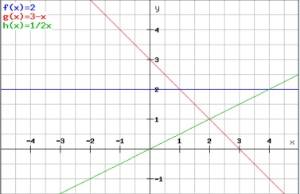

An industrial tool is made from alaminar material occupyingthe region between thestraight lines y =2, y=1 2x and y =3−x. The density of thematerial varies and is given by thefunction σ(1 + x), where x is the horizontal distancefrom the y-axis and σ is aconstant. The mass of the tool andthe position of its centre of mass are sought.
(a) Sketch the region, and find the coordinates of the vertices.
(b) Calculate the mass of the tool in terms of σ.
(c)Find the coordinates of the centre of mass of the tool.a)
The vertices are the points (1,2), (2,1) and (4,2)

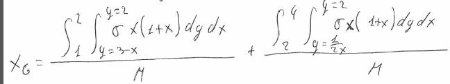

Now I'm confused on how I find the coordinates of the centre of mass.
Since the coordinates are
But I have two double integrals, then do I need to sum both of the X double integrals to find the X-coordinate?
Yes, and there will be two integrals involved in finding the y-coordinate of the C.O.M.as well.

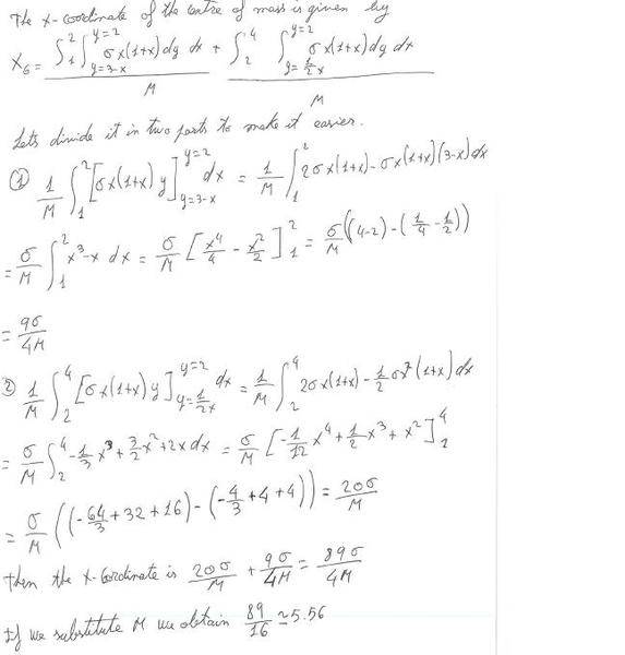

ok, so this is what I did
But the result is 303/16≈18.94 and this clearly is not the X-coordinate of the centre of mass.
Can anyone help??
You are not showing the details of your calculations. If you post these, you might get some suggestions.
Ok, I think I did a mistake when I did the calculations. I've done it again and the X-coordinate is 89/16≈5.56
C.O.M. coordinates generally lie within the boundaries of the body. Your calculation shows the C.O.M well outside.
You don't show your working for M. I get 5, not 4.
In the calculation starting at (2), the coefficient of x3 is wrong in the second line.
Yes, you are right.
I've done the calculations again and the M=5
Also I've done the calculations again for the coordinates and everything looks correct since the coordinates lie within the shape.
Thank you for your help.
