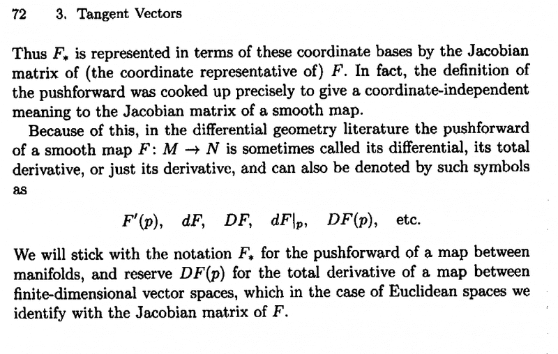

I am reading John M. Lee's book: Introduction to Smooth Manifolds ...
I am focused on Chapter 3: Tangent Vectors ...
I need some help in fully understanding Lee's conversation on computations with tangent vectors and pushforwards ... in particular I need help with a further aspect of Lee's exposition of pushforwards in coordinates concerning a map [itex]F: M \longrightarrow N[/itex] between smooth manifolds [itex]M[/itex] and [itex]N[/itex] ... ...

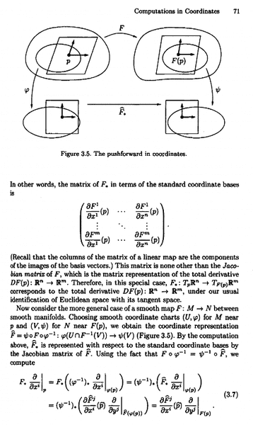

The relevant conversation in Lee is as follows:

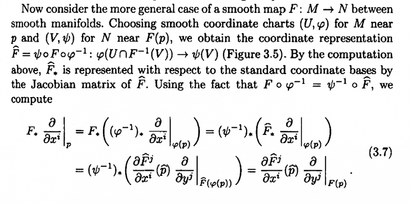

In the above text, equation 3.7 reads as follows:
[itex]F_* \frac{ \partial }{ \partial x^i } |_p = F_* ( ( \phi^{-1} )_* \ \frac{ \partial }{ \partial x^i } |_{\phi(p)}) [/itex][itex]= ( \psi^{-1} )_* \ ( \tilde{F}_* \frac{ \partial }{ \partial x^i } |_{\phi(p)} )[/itex][itex]= ( \psi^{-1}_* ) ( \frac{ \partial \tilde{F}^j }{ \partial x^i } ( \tilde{p}) \frac{ \partial }{ \partial y^j }|_{ \tilde{F} ( \phi (p))} )[/itex][itex]= \frac{ \partial \tilde{F}^j }{ \partial x^i } ( \tilde{p} ) \frac{ \partial }{ \partial y^j }|_{ F (p) }[/itex]... ... ... ... ... 3.7
I cannot see how Equation 3.7 is derived ... can someone please help ...
Specifically, my questions are as follows:Question 1
What is the explicit logic and justification for the step
[itex]F_* ( ( \phi^{-1} )_* \ \frac{ \partial }{ \partial x^i } |_{\phi(p)})[/itex] [itex]= ( \psi^{-1} )_* \ ( \tilde{F}_* \frac{ \partial }{ \partial x^i } |_{\phi(p)} )[/itex]
Question 2
What is the explicit logic and justification for the step[itex]= ( \psi^{-1} )_* \ ( \tilde{F}_* \frac{ \partial }{ \partial x^i } |_{\phi(p)} )[/itex][itex]= ( \psi^{-1}_* ) ( \frac{ \partial \tilde{F}^j }{ \partial x^i } ( \tilde{p}) \frac{ \partial }{ \partial y^j }|_{ \tilde{F} ( \phi (p))} )[/itex]
Question 3
[itex] ( \psi^{-1}_* ) ( \frac{ \partial \tilde{F}^j }{ \partial x^i } ( \tilde{p}) \frac{ \partial }{ \partial y^j }|_{ \tilde{F} ( \phi (p))} )[/itex][itex]= \frac{ \partial \tilde{F}^j }{ \partial x^i } ( \tilde{p} ) \frac{ \partial }{ \partial y^j }|_{ F (p) }[/itex]
As you can see ... I am more than slightly confused by equation 3.7 ... hope someone can help ...Peter

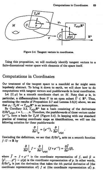

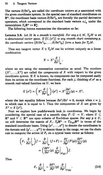

To give readers the notation and context for the above I am providing the text of Lee's section on Computations in Coordinates (pages 69 -72) ... ... as follows:

Math Amateur said:
Question 1
[itex]F_* ( ( \phi^{-1} )_* \ \frac{ \partial }{ \partial x^i } |_{\phi(p)})[/itex][itex]= ( \psi^{-1} )_* \ ( \tilde{F}_* \frac{ \partial }{ \partial x^i } |_{\phi(p)} )[/itex]
Applying ##\psi^{-1}## to both sides of the definition of ##\hat F## we get
$$\psi^{-1}\circ\hat F=\psi^{-1}\circ\psi\circ F\circ\phi^{-1}=
F\circ\phi^{-1}$$
We then use the property of pushforwards ##(A\circ B)_*=A_*\circ B_*## to obtain
$$\psi^{-1}{}_*\circ\hat F_*=\psi^{-1}{}_*\circ\psi\circ F_*\circ\phi^{-1}{}_*=
F_*\circ\phi^{-1}{}_*$$
Applying both sides of this to ##\frac{ \partial }{ \partial x^i }|_{\phi(p)} ## and using the associative law for function composition, we get the result.

Question 3 is easier.
We want to justify
$$ \psi^{-1}_* \left( \frac{ \partial \hat{F}^j }{ \partial x^i } ( \hat{p}) \frac{ \partial }{ \partial y^j }\Big|_{ \hat{F} ( \phi (p))} \right)
= \frac{ \partial \hat{F}^j }{ \partial x^i } ( \hat{p} ) \frac{ \partial }{ \partial y^j }\Big|_{ F (p) }
Proceed as follows
\begin{align*}
\psi^{-1}{}_* \left( \frac{ \partial \hat{F}^j }{ \partial x^i } ( \hat{p}) \frac{ \partial }{ \partial y^j }\Big|_{ \hat{F} ( \phi (p))} \right)
&=\frac{ \partial \hat{F}^j }{ \partial x^i }( \hat{p})\ \psi^{-1}{}_* \left( \frac{ \partial }{ \partial y^j }\Big|_{ \hat{F} ( \phi (p))} \right) \\
&=\frac{ \partial \hat{F}^j }{ \partial x^i }( \hat{p})\ \left(\psi^{-1}{}_* \left( \frac{ \partial }{ \partial y^j }\Big|_{ \psi(F(p))} \right) \right)\\
\frac{ \partial }{ \partial y^j }\Big|_{ F(p)}\\
\end{align*}
The first equality follows from linearity of ##\psi^{-1}{}_*##, the second from the definition of ##\hat F## and the third from Lee's definition in the first equation after the heading 'Computations in Coordinates', but this time applied to the pair of spaces ##N,\psi(N)## rather than ##M,\phi(M)##.
Likes Math Amateur
