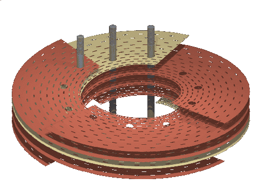

... but due to the large flat parallel surfaces isn't the capacitance higher than in an ordinary coil?
Yes. The capacitance depends on the overlap and separation between plates. But you can make a transmission line resonator rather than a coil and capacitor.
The magnetic field is concentrated in the centre hole. You can have a strong field or a large area.
For the fields you are demanding a normal wire coil will be forced outward and stretched by the field. How will you cool the coil?
I don't know for sure but it looks like bitter magnets are mainly DC?
As mentioned the inter winding capacitance would make this difficult to work at higher frequency.
Looks like basically a helical coil made of individual plates? Sort of like how some planar transformers are build?
243232
Well the bitter coil is basically a very thick flattened wire wound in the shape of a coil with holes to allow for cooling to run through. but as already mentioned the capacitance would be very great compared to other coil types.
Also the reported field strengths with bitter magnets seem huge (record about 45T) but I think @essenmein is correct in the assumption that it is a static DC field with static DC current through the coil? maybe low frequency AC, also the problem is that it seems the field is concentrated in a rather small circular area essentially the middle of the coil, which doesn't suffice for my application sadly.

You must trade area for field strength = lines per square metre.
The strongest field requires the smallest possible area.
You must have amp * turns.
You must wind a conductor around the field area.
Resistance, R is proportional to number of turns. Losses are I squared * R.
Weight of conductor? One thick turn = R, or two turns, half as thick = 4 * R.
You want a higher current, so you need a lower impedance.
Transmission line; Z=√(L/C). High current, implies higher C, lower L.
A coaxial line has higher capacitance than a ladder line, but still works at RF.
Inductance, L is proportional to number of turns squared.
At RF you must reduce turns, so you can have higher C, for more amps.
Magnetic self-forces on an inductor are square law, so rapidly become destructive.
Stray self capacitance is lower when inductor sheet currents are edge-on.
So don't dismiss a one or two turn bitter magnet plate as a tank circuit.
