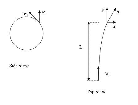

OK, I put the pen down and got the result. You have to suppose that Coriolis effect is small. It is because the angular velocity of the Earth is small, 1 turn a day. Maybe the below picture helps you.

Weimin, I think you forgot the picture...

Hmm, for some reason, the attached did not show up. I do it again.
I suppose that the up-north speed is constant since the Coriolis effect is small. So the force towards the East is also constant. The trajectory of the bullet can be treated as a thing being thrown horizontally with a small gravity.
But look at the values you gave,I wonder why the bullet is slow down too much after 2 sec.
