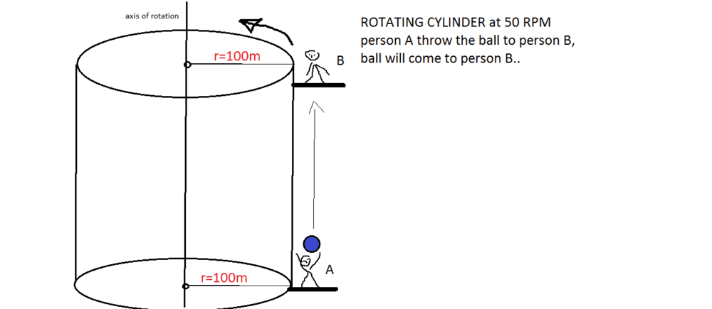

In summary: If you release the ball at the same time as the person climbs the tower, they will see the ball land in the middle of the ocean. The reason is that the tower and the person are rotating with the Earth, and the ball is moving eastward at a speed proportional to the square of the tower's height. So the ball will go as far east as the tower goes up, and then as far west as the tower goes down.

I will ask just one simple question to your video..
If I "sit" inside this cannonball will I feel centrifugal force,(just like when drive car fast in corner) or not?
If I feel centrifugal force that mean that cannonball is curving,if not, that mean is going in straight line..
In the car you feel the deformation from the interaction force by the car on you.
The ball is inertial here, so the passenger would not feel any forces from the walls.

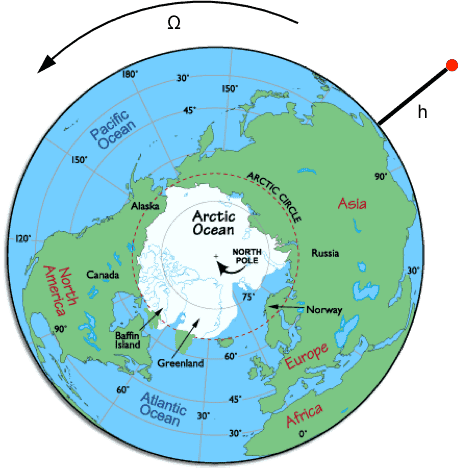

And here is an elaboration of the points made by @A.T. and @boneh3ad. Suppose you build a very tall tower of height ##h## on the equator somewhere in SE Asia. The figure shows the Earth in an inertial frame view looking down at the north pole; the arrow indicates the sense of the Earth's rotation. You stand at the base of the tower and ask a friend to climb to the top stick his arm out and release a red ball straight down.
Neglecting air resistance, where will you see the ball land on the Earth?
(A) At a point behind the base of the tower.
(B) At a point right at the base of the tower.
(C) At a point ahead of the base of the tower.
The correct answer is (C).
Explanation: While the ball is in the air, the only force on it is the radial force of gravity; there is no tangential acceleration. Before the ball is released it has a higher tangential speed vball = Ω (RE + h) than the base of the tower vbase = Ω RE in the inertial frame (RE = Earth's radius). That higher speed is retained throughout the flight, so the ball will land ahead of the base of the tower. You, in the non-inertial frame, would expect the ball to land right at the base of the tower because you know that the only force acting on the ball is gravity which is along the tower. The fact that it does not, leads you to the conclusion that there must be some kind of horizontal force other than gravity acting on the ball. This is what @A.T. calls the Eötvös effect and @boneh3ad calls "inertial effects".

(Do you maybe have answer why horizontal correction exist even when you shoot est-wet, west-est?)
  • #35
T
Because the Earth is rotating under the projectile as it flies. If you are anywhere in the northern hemisphere then the Earth is like a phonograph platter that is rotating counter-clockwise. If you are shooting east, the platter in front of you is rotating left/northward. If you are shooting west, the platter in front of you is rotating left/southward. If you are shooting south, the platter in front of you is rotating left/eastward. If you are shooting north, the platter in front of you is rotating left/westward.
Near the north pole, the picture is just this simple. As you approach the equator, the platter is tilted so that the rotation is no longer about a vertical axis. The horizontal component of the deflection is weakened accordingly and replaced with a vertical component that varies with direction (tending to produce drop if you shoot east and lift if you shoot west but no effect if you shoot north or south). As you proceed south beyond the equator, the horizontal Coriolis component re-emerges, but reversed. Now the phonograph platter is viewed from below. From this viewpoint it is rotating clockwise.
