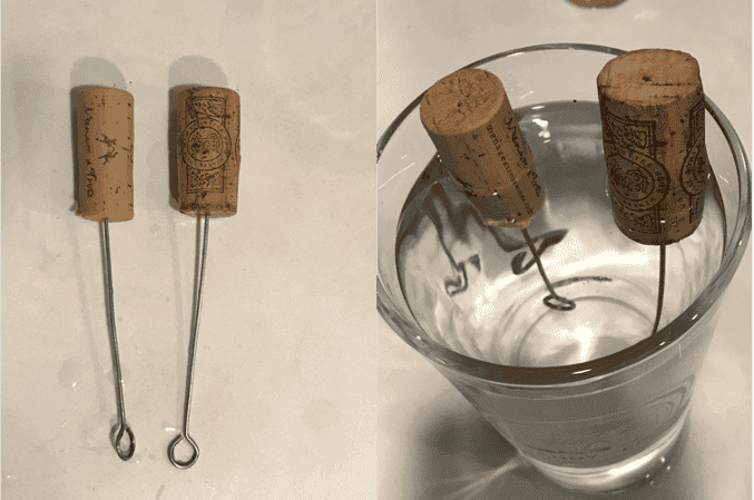

Are these corks cylindrical like from wine bottles? If so, here is a kitchen countertop experiment I tried. I attached turkey lacing pins (thin nails would work just as well) to the bottom of one synthetic and one natural cork (figure below, left.) Then I floated them in a glass of water. The pins ensured that the corks would float more or less upright (figure below, right). One can use the diameter of each cork as a measuring stick to estimate the fraction of submerged length to diameter.
Edit: A little dye in the bath will show the submerged volume better when the corks are pulled out.
