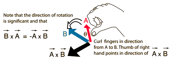

When you take calculus(i'm told nowadays they teach it in high school !) you'll learn vector cross products, which are easier than the name implies...
watch this:
Lorentz in words:
"Force F on a charge Q moving at velocity V in field B is Q V cross B",
in mathspeak:
F= Q X (V cross B) , and (V cross B) is called the "vector cross product"
Since that's an academic definition you'll apply it to the charge used in academic circles, conventional aka positive, charge.
Commit this sentence to memory:
"Direction of a vector cross product is that taken by a right handed screw rotated in direction of first vector into second ."In this picture
Observe that a right handed (conventional) screw when rotated counterclockwise as shown , will move in direction indicated by the black arrow.
If it helps you to imagine this, think of arrows A and B as indicating the initial and final directions of the slot in the screwhead.
That's a powerful word picture that'll serve you well. At least it served me well.
F = QV cross B
Conventional charge,conventional screw, rotate V into B. Practice it.Using just that you can explain why a motor makes torque and why as it begins to turn it develops counter EMF.
