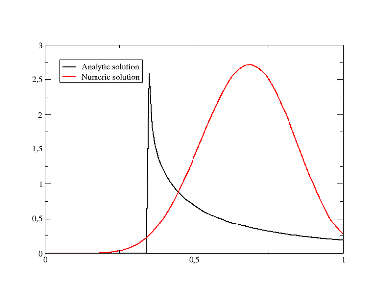

Ok, actually the equation I am solving is this one (I've introduced the thread with diffusion because it was easier, and it is asymptotic to it for large ##\mu_s##:
##\frac{1}{c}\frac{\partial I(\mathbf{r},\hat \Omega, t)}{\partial t}+ \hat \Omega \cdot \nabla I(\mathbf{r},\hat \Omega, t)+\mu_s I(\mathbf{r},\hat \Omega, t)=\frac{\mu_s}{4\pi}\int_{4\pi} I(\mathbf{r},\hat \Omega, t) d\hat \Omega+\delta(\mathbf{r})\delta(t)##
This is a linearized Boltzmann equation.
What I am plotting is the photon scalar flux, which is defined as: ##\phi(\mathbf{r},t)=\frac{1}{4\pi}\int_{4\pi} I(\mathbf{r},\hat \Omega, t) d\hat \Omega##.
The analytic solution for infinite (3D) homogeneous media also involves a Dirac delta function, which physically represents the unscattered particles:
##\phi(\mathbf{r},t)_{an}=\frac{e^{-ct\mu_s}}{4\pi r^2}\delta(r-ct)+\frac{(1-r^2/c^2t^2)}{(4\pi ct/3\mu_s)} e^{-ct\mu_s}\times e^{ct\mu_s[1-r^2/c^2 t^2]}\sqrt{1+\frac{2.026}{ct\mu_s[1-r^2/c^2 t^2]}} \Theta (ct-r)##
Here ##\Theta## is the heaviside step function.
This is actually an approximation to the analytic solution, which is not exactly known in closed form, but it is proven in a paper that the error is of the order of 2% to the truth solution.
The thing is that this solution involves a Dirac delta function, so I was thinking that perhaps I am not being able to numerically reproduce this behavior because it is not so well behaved. The domain I am working with has 10 units per side, I am using c=1, and in the picture I have used ##\mu_s=1##.
I have also tried with ##\mu_s=0.1##, and the propagating wave looks like a gaussian, it doesn't resemble the Dirac delta that is clearly seen in the analytic solution.
The r for the analytic solution is ##r=\sqrt{0.12}##.
Also, how should I work the dimensional analysis for this equation in order to obtain a relation for ##t_0##?
I am thinking that perhaps the smoothing of the Dirac delta impulse is due to the spatial grid. The analytical solution is obtained from Fourier space, and then a Fourier transformation is used. It is exact in that sense, the approximation comes from the fact that the inverse has no closed solution in 3D, but it does in 2D and 4D, so an interpolation formula is used.
So, I was thinking that perhaps I should look far away from the source, so the delta function, within a scattering medium, will be hardly attenuated far away from the source, and I would expect that the numerical situation looks more like the analytical one. The stepsize I am using is ##\Delta x=\Delta y=\Delta z=0.1##. I was trying to avoid using a huge domain, because the computational work involved scales very rapidly.
The numerical solution I've obtained in this regime (the one in the picture) is probably wrong due to another fact: I should have used a much finer discretization in the ##\hat Omega## than the one I was using for the highly scattering regime.
