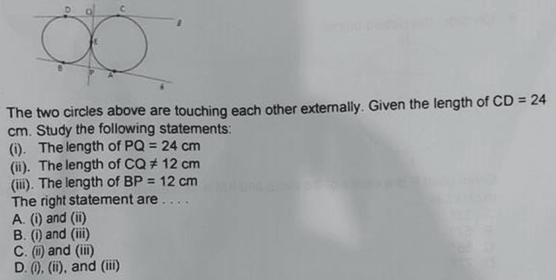

(external common tangent)[SUP]2[/SUP] = (distance between center)[SUP]2[/SUP] - (R - r)[SUP]2[/SUP]
Let R = radius of big circle and r = radius of small circle.
I worked out that ##R \times r=144## but then not sure how to proceed. I also know AB = CD = 24 cm.
Thanks

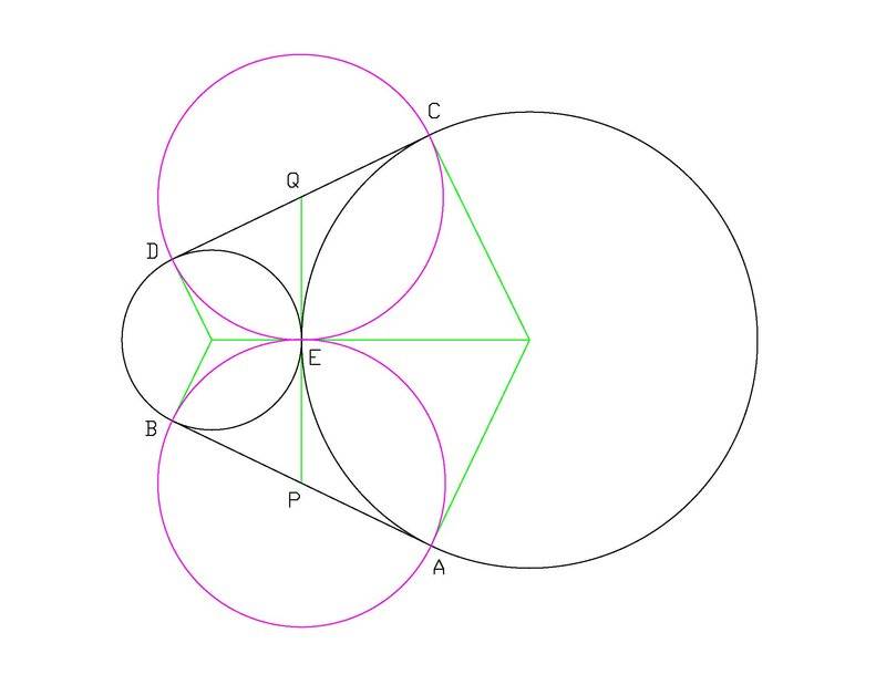

If you draw a diagram with very different radii, you could easily see the right answer.
Also, for answering (i), draw the radius that are perpendicular to the tangents for each circle.

I understand. The correct answer is (B).

I am not sure about that answer, songoku.
Is it the official correct one?

No, it is not official answer. It is my own answer.
I thought the value of PB and PE will be the same since it is tangent from common point. Same thing for PE and PA so it means that PA = PB = 12 cm.
I used the same reasoning for QD and QE and also QE and QC so QD = QC = 12 cm
Since PE = 12 cm and QE = 12 cm so PQ = 24 cm
Is there something wrong with my working? Thanks

Your reasoning and working are perfect.
Mine were not.
Thank you!
