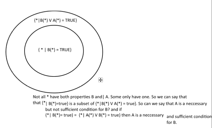

If an object type ◌ exists and within the set of these objects exist some which have both well defined properties A and B, and some which only have the property A. There is at least one ◌ which does not have both properties.
Thus say we create the set of such objects such that A or B (inclusive or) is true. And we create the set of ◌ such that property B is true. It then becomes that:
[tex]\left \{ \cdot | B(\cdot ) = true \right \} \subset \left \{ \cdot | B(\cdot ) \vee A(\cdot ) = true \right \} [/tex]
We can then say that A is a necessary but not sufficient condition for B. If there do not exist any where only one of a or b apply then:
[tex]\left \{ \cdot | B(\cdot ) = true \right \} = \left \{ \cdot | B(\cdot ) \vee A(\cdot ) = true \right \} [/tex]
In which case it becomes that A is a necessary and sufficient condition for B. Or, b is a neccesarry or sufficient condition for A. (due to symmetry of equivalence).
It could be that I am misinterpreting your notation, so please correct me as I go. First, I assume there are brackets around "A(.)∨B(.)", and that there is an understood evaluation operator , so that , for example, we are talking about {.|val[(B(.)∨A(.))] = true}, or something like that.
Next, I am not quite sure how your subject line relates to your development. What is supposed to be implying what?
Next, in your development, suppose we have B being a tautology and A a contradiction. In this case, your line

as one usually interprets "necessary and sufficient" to mean mutual implication. That is, you seem to require a contradiction and a tautology to be equivalent (under mutual implication).
Please clarify.

Yes, there are brackets.
Sorry, b(*) simply means some proposition in which the * is the object in place of the variable...kind of like p(x): x is an even number...
in my case I am trying to generalise for two properties/propositions for which the object in oplace of the variable gives a truth value of true.

hmm yes I read it but I was thinking in purely set theoretic terms, eg..
take the set of numbers which are natural and even (two well defined properties) make sets of their properties...
Set C in reals such that A(x) : x is a natural number. (property, well defined)
Set D in reals such that B(x) : is an even number. (property, well defined)
A(x): x is a natural number. being true is a necessary but not sufficient condition for B(x):is an even number..
This is because the set of even numbers is a subset of Natural numbers.
So I was wondering whether my reasoning could NOT be extended to all general situations, where A and B are two properties with truth values..? or is this not the correct way to think about logical implication?
