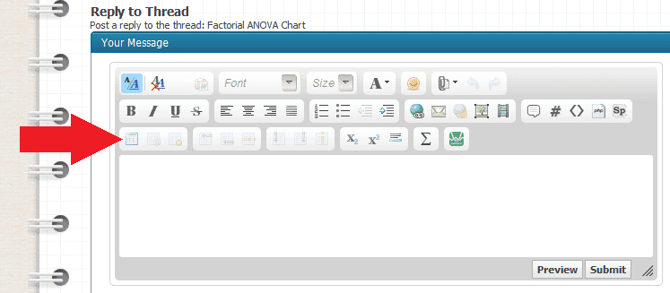

Hi there. Can you try putting this info into a table? That will make it easier for us to read. Click on this button. View attachment 3576
With ANOVA tables it's all about making sure everything adds up, especially the degrees of freedom. I'll do my best to look it over when it's readable. :)

That's weird that you can't see my picture. Are you using a phone or tablet maybe?
Anyway, click the first button on the fourth row all the way to the left. It looks grid like.

Jameson, perhaps the OP assumed there was an image to view by clicking the image you posted.
MWR, Jameson is referring to the following button on our toolbar:
Click that button and it will allow you to define a table for presenting your data. :D
