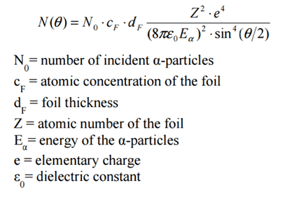

Thank you for the answer but my lab work is no where near as advanced as what you have written. The goal of the experiment was to collect data at varying angles and to validate Rutherford's formula:
All the constant are taken out and put into one (A) to give:
The collected data has to be plotted next onto this theoretical curve and then the values of B and A are to be determined graphically (trial and error for the best match). The main reason for this experiment is to become proficient at data analysis and to get used to writing scientific reports. Now my problem is I don't know how to correct for the fact that the data was collected in only one plane.
I didn't collect data at 0 degrees (going straight through) as the instructions specifically requested to omit this reading. Also I don't understand how that reading could be of any use when Rutherford's scattering formula has an asymptote at 0 degrees.

It looks like all they are looking for from you is to try to curve fit ## N(\theta)= A/sin^4(\theta/2) ## for a range where you got reasonably good data. At ## \theta=0 ## this number goes up the y-axis, but you could try a graph of ## N(\theta) ## vs. ## \theta ## from ## \theta=180 ## (back-scattered) to some angle ## \theta= 45 ## degrees, etc. i.e. compare theoretical to experimental and choose ## A ## for the best fit to your experiment. ## \\ ## Editing... If you measured the angle in the laboratory, the ## B ## in your formula should be equal to zero. I'd enjoying seeing a few of your data points of ## N (\theta) ## vs. ## \theta ##. ## \\ ## Incidentally, it was with Rutherford's experiment that they came to conclude there were actually nuclei in atoms. Up until this time, they thought solids were pretty much uniformly dense, like jello, and they never expected that a piece of gold foil would be able to deflect one of these alpha particles appreciably.

Does that mean that I do not need to correct the data in any way? The lab script says "In order to compare your results with “Rutherford’s scattering formula”, you must first make a correction for the fact that we have only sampled the scattering in the horizontal plane, whereas the α-particles are actually scattered in a 3D cone." and then "Consider what factors make a correction to the angular scale necessary.". I am perfectly fine with all other aspects of the experiment and didn't even think I would need to change the data in any way, however, these two sentences threw me off-guard.
And yes I am aware that B should be 0, however, in the apparatus used the source and detector were not aligned perfectly and therefore the actual peak was around 2-3 degrees.
Edit: What you said about fitting my data onto the curve is exactly what they are asking.

The angle ## \theta ## is the polar angle. Had you collected data in 3-D, you would have found a complete ## \phi ## symmetry. That is why ## \phi ## does not appear in the Rutherford formula=it's independent of ## \phi ##. Your laboratory angle is precisely ## \theta ##, neglecting any misalignments, etc.

One additional comment: You may have taken data for angles ## \theta ## on both sides of the peak at ## \theta=0 ## degrees. In the polar coordinate system of interest, these are actually the same angle for ## \theta ## on both sides of the peak, but the azimuthal angle ## \phi ## differs by ## \pi ## radians or 180 degrees at these two locations.
