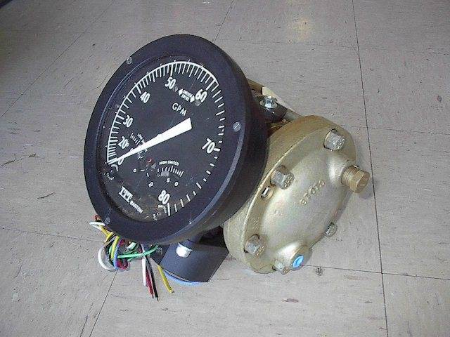

But with a highly compliant transducer like a bellows driven dial indicator
you can wind up with a Helmholtz resonance slow enough to interact with control systems...

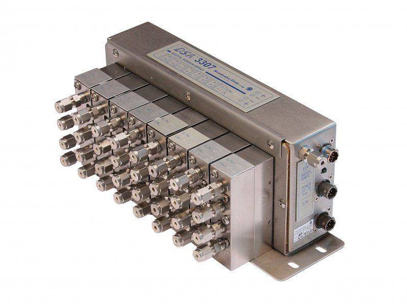

It's quiet scientific topic because I am just doing my thesis with DSA3307 differential pressure device which can measure 500 hz/channel. My professor just wants to know generally, what is the effect of this vibration into pressure transmission line's velocity profile? What is the influence of backflow? He wants me to find a relationship between voltage and pressure as well. Actually, This is called as unsteady pressure measurement and correlation. In literature, I didn't see anything about the effect of backflow in transfer function. He just told me that this is negligible but proof it. I checked a lot of sources but couldn't find anything.
One has to assume a driving pressure(noise)
then apply that function to the mechanical system of the transmitting sense line, as in that paper you linked
and see what arrives at the sensor
so :
are the sense lines filled with compressible or incompressible fluid ?
What is its mass?
What is displacement vs pressure of the sensor at end of that sense line?
Now you have a spring-mass-damper system that'll lend itself to analysis just as in harmonic motion physics homework problems(see conclusions paragraph).
that seems to be the thrust of that paper.
You can design your sense lines to avoid resonance in your frequency range of interest, or just demonstrate there are none..
