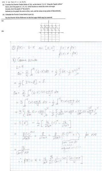

See figure attached for problem statement as well as my attempt.
I'm not fully convinced I've done the sketch of the cosine series correctly or not, are there any mistakes?
Also, when solving for, [tex]a_{n}[/tex] I changed the n around so it would only contain the odd numbers.(it's 0 otherwise) Can I do this and have I done this correctly?
Thanks again!

I'm not fully convinced I've done the sketch of the cosine series correctly or not, ...
Me neither. Wouldn't a sum of cosines give an even function?

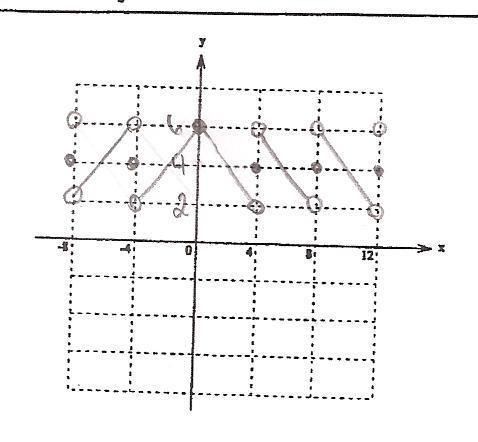

Hmmm... Then the sketch should look like this, correct?

Is that sketch the graph of a periodic function?
Well it says to sketch the Fourier Cosine series, the Fourier cosine series turns any function into a periodic function in terms of summations of cosines, right?
Yes, it does. And you are supposed to sketch it. So I ask you again. Is your new sketch periodic?

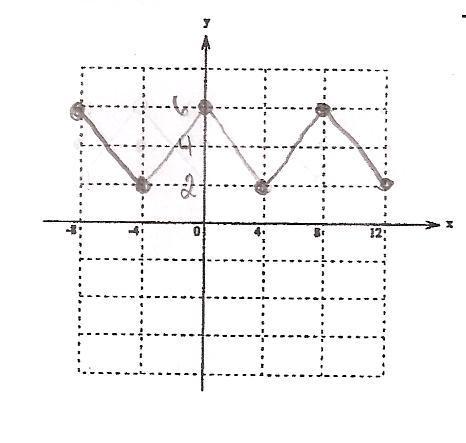

I spotted my mistake now. Since my series is a cosine series my period is from -4 to 4, the sketch should be as follows.
Much better.
