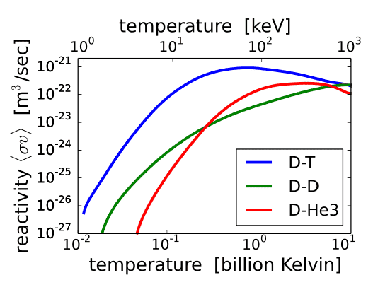

What about the bremsstrahlung radiation lost in a nuclear fusion reactor, I hear it's harvested by heating the steel walls, why not cover the walls with like solar panels but with band gaps that absorb energy more efficiently in the x ray region?
To my knowledge solar panels cannot be made for the X-Ray range.
How well would bremsstrahlung losses have to be recovered in order for a nuclear fusion reactor to make more energy than it requires for ignition?
That depends on the losses due to the radiation vs the reaction rate, along with a whole lot more, like efficiency of the energy conversion process. However, you're missing a very very key point here. We haven't even hit breakeven yet, meaning that we can't even get a reaction to put out more energy than we have to put in. And this is just talking about total energy from the reaction before being harnessed, we still have to account for losses and inefficiencies.
