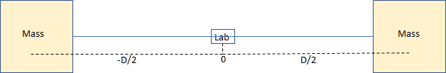

TL;DR Summary
I want to investigate/discuss/quantify the strength of the cosmological tidal force caused by accelerating cosmic expansion
In order to make it as simple and non-controversial as possible, I propose a setup where inhomogeneity and change of reference frames play as little role as possible, i.e. in free space and with its center of mass comoving. I'll call that point the origin and set up my lab there. Rockets deliver two identical masses a distance D/2 in opposite directions, attach a cable from each to the lab and allow the situation to stabilize as something like this, with the cables taking some cosmological stress due to accelerating expansion.
We can measure the cosmological 'tidal' force (CTF) on the cable in the lab by inserting a strain gauge. But before that we should calculate the OOM, so that we can insert a properly scaled strain gauge. Using standard cosmological equations, I get the CTF:
$$CTF = D H_0^2 \left(\Omega_{\Lambda} - \Omega_M/(2a^3)\right)$$
(From Peebles 1993, eq. 13.3, p 312)
At present, with a=1 and the Omegas 0.7 and 0.3, with Ho roughly 0.072/Gyr2, it works out to:[1]
CTF ~ 2.9x10-11 D Newton/kg, with D in Glyr, or in easier terms:
29 nano-Newton per kg mass per Glyr separation.
Unless I have made some serious blunders in conversion, this is a small force, really small, unless we make the two masses very large...
Note [1] Since I often play around with Gyr, meaning acceleration is geometrically in the units Gyr-1, I find it very convenient that
1 Gyr-1 is very close to 1 nano-g (Precisely 0.970735785686955 ng).

I am afraid that the wire is loosened by the approach of the two massive bodies to each other due to universal gravitation force of
[tex]-G\frac{M^2}{D^2}[/tex].
Not here. The gravitational interactions between (all the) masses (in the universe) are already taken into account in the evolution of the scale factor, together with the influence of the cosmological constant. As you can see from the equation, with sufficiently diluted mass density the contribution from the cosmological constant takes over and keeps the string taut.

I apologize to all who have misunderstood the scenario that I have presented. I should have made it more clear that I was talking about cosmological distances and I should have done a better job of the schematic.
That said, I should also have stressed that the equation that I've used is a weak field approximation and not a full relativistic one. This implies that the two masses should not be excessively large and the distances large, but not something near a Hubble radius apart.
The equation should however hold for galaxy (or even cluster) sizes and masses and distances into the hundreds of millions of light years, where we can assume weak gravitational fields and Hubble rates well below the speed of light.
This is where the effect of the accelerating expansion is simple enough to be very closely approximated by the (Peebles) equation given in the OP. If anyone knows a reference for a more general relativistic equation, I would be grateful.
PeroK said:
If there is a cable of cosmological scale under strain, then does that represent a non negligible stress energy within the experimental setup?
The idea was that the cables are only attached to a strain gauge in the relatively small lab; so the lab itself is under negligible strain.

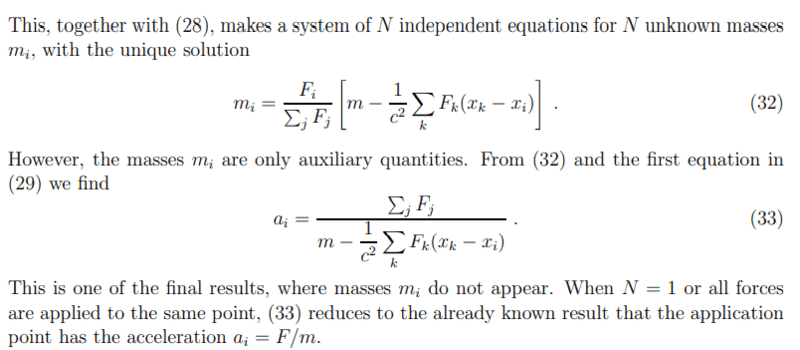

PeterDonis said:
If we are in the weak field regime, then, as above, the strain in the cable must be small compared to its energy density, so you can't neglect the mass of the cable.
It is easy to calculate the mass of the cable and also how it is distributed. What is not so easy is to calculate is the force contributed by the distributed mass. The cable mass will contribute zero at the lab and more and more for the more distant parts being forced off their geodesics.
H. Nikolic's Relativistic contraction of an accelerated rod analyzes a different problem, but his method described in section 5 pages 7 to 9, applicably adapted, might be useful here, e.g.

After this reply, the thread went into a "highly A" level, so I thought about a way to simplify it somewhat. Is it possible to do away with the cable and all its complexities? Perhaps.
If we (one day) have the technology to put two labs, each of non-negligible mass M, somewhere in the intergalactic void, separated by a proper distance D, is there a 'critical distance' Dcritical, call it Dc for brevity, where the gravitational acceleration and the cosmological acceleration cancel each other?
In the weak field limit (at least), the answer is yes. They will each create an attractive acceleration of (geometric) magnitude ##\frac{M}{(0.5D)^2}## in the frame of their common center of gravity, for a total of ##\frac{0.5M}{D^2}## when added together. This is to be compatible with the measurement of the OP's strain gauge at the midpoint.
So we can find Dc by equating this acceleration to the OP's CTF, i.e.
$$\frac{0.5M}{D^2} = D H_0^2 \left(\Omega_{\Lambda} - \Omega_M/2\right)$$
and I found
$$D_c = \left(\frac{M}{H_0^2} (\Omega_{\Lambda}-\Omega_M/2)\right)^{1/3}$$
If this is correct for the present time, does it give us a potential way to measure the Cosmic Tidal Force (CTF)? That is, by precisely measuring that they stay at the constant distance Dc for long enough?
