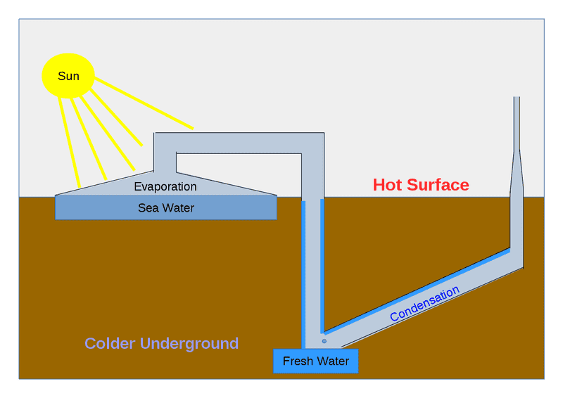

Capturing steam is all about removing heat.
From the link @russ_watters provided:
The temperature of the ground temperature below ~ 1m is around the daily average temperature. With some tricks it can be lowered further, closing it to the daily lowest temperature.
In short: bury the pipes, and let the condensate flow to the lowest point for collection.
Since the incoming heat will slowly heat up the ground, airing the pipes (or: adding airing pipes, open only for the night) at night will help.
Likes thdm
