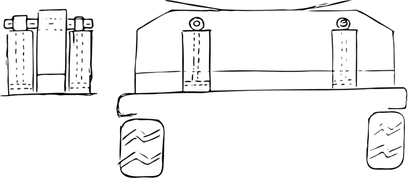

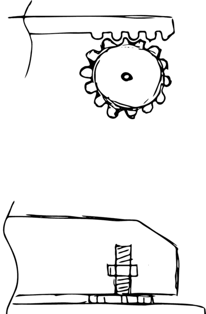

Hi everyone,
I am in concept phase of designing a lifting mean for 750 ton, I have many ideas using hydraulics which I could cost estimate online. However, one of the ideas is using rack and pinion combined with lead screw with its sizes determined from rough stress calculations. So, does anyone have an idea how to cost estimate the following?
1) Screw and nut
- Diameter = 160 mm
- Length < 1 m
- Lead angle = 10 degrees
- Yield stress > 235 MPa
2) Rack and Pinion
- Module = 40
- No. of teeth = 10
- Pinion thickness = 200 mm
- Pressure angle = 20 degrees
- Rack Length = 8 meter

Is this a homework problem? Because it looks like one. If so, we can move it.
BTW, some very quick calculations show that your design cannot possibly work.
I am not aware of any good ways to cost estimate machine parts that are far removed from standard production parts. That's because the cost is a function of the capability of the particular machine shop, your design specifications and tolerances, and their willingness to do the job.

Welcome to PF.
A rack and pinion is not a sensible solution to a 750 tonne problem. Everything is working against it. No mechanical advantage is gained by a rack and pinion. The pinion caries the total load on one tooth. The pinion must be wide and perfectly aligned with the rack. To get greater tooth area in contact, the pinion evolves to be an acme nut, while the rack becomes an acme screw, which makes it a screw jack.
The biggest vertical-axis screw jacks, available off-the-shelf for industrial applications, have an acme thread that does not rotate. The acme nut is internal to the housing, in the form of a worm wheel, driven by a horizontal-axis worm screw. IIRC, the ones I used were limited to one hundred tonnes. It seems hydraulics has taken over by about 1000 kN ≈ 100 tonnes
https://www.powerjacks.com/products/screw-jacks
For 750 tonnes, the obvious solution is hydraulic.

Hi Jrmichler,
It is not a home work, it is an acutual adjustment to spmt (Self-propelled modular transporter) with two saddles lifting 1500 T wind turbine monopile.
Thanks for the answer, it is unpractical idea but if cost was way less than hydraulics then I would try to go further with it.

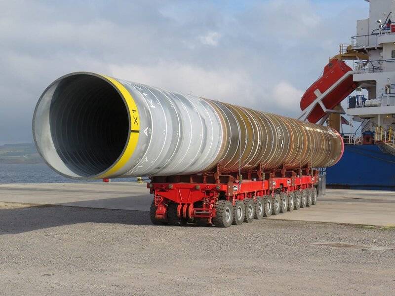

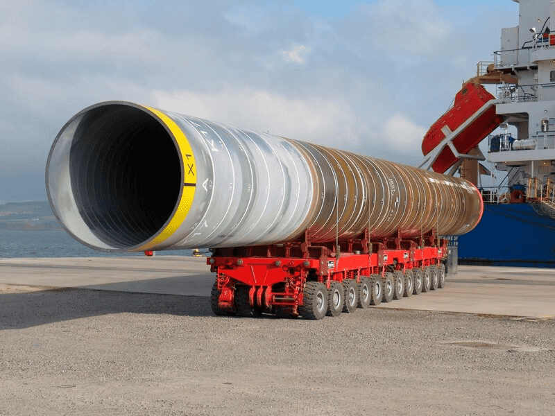

On an associated subject, the Port of Long Beach in California is planning a new pier where LARGE wind turbines can be assembled, then towed to the NorthWest coast of the USA. Up there the wind is particularly strong, reliable, and peaks in the late afternoon/evening, around peak usage hours.
The project consists of dumping much dirt/rocks in an unused area of the harbor and renting assembly areas to various turbine manufacturers... and it is adjacent to the deep-water port entrance, which is inside a massive breakwater. (The port originated as the home of the U.S. Navy West Coast Fleet, which moved to San Diego many years ago.)
They expect about 2 years to build each turbine.
This is still in the planning and environmental impact stage but the locals seem enthusiastic or at least accepting.

The task is to lift it 500 mm while transportaion on the SPMT so the task here is not picking it up.

So far I am thinking of four cylinders per each saddle with pinned end connection to relief rods from reaction moments (sketch attached but without accurate relative dimensions). Also for the hydraulic circuit I will add LHV (Load holding valve) with a directional valve to ensure safety and provide flexible heights.
I don't have experience in lifting, so I would like to know your opinions on drawbacks of this approach and your recommendations.
This is a reasonable approach if all of the engineering is done correctly. If you search large hydraulic cylinders, you will find manufacturers that can make cylinders much larger than you would need. You could do it with two cylinders per saddle if that would result in a better configuration. Be careful to avoid sideways forces if using base mount cylinders.
Hydraulics is a good approach for very large loads, and when you want to load share between two hydraulic cylinders. Overload protection is a simple pressure relief valve.
