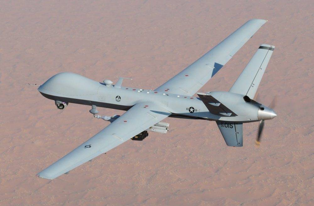

tech99 said:
I think there is huge difficulty doing this. I presume you mean video at 4kbit/s. That is very slow indeed, so each low resolution frame would take a few seconds. It is difficult to obtain communication over 50km with small antennas and reasonable transmitter power when the aircraft is low.
I think there is a misunderstanding caused by me since I didn't specified the type of UAV. It won't be a typical drone, it's HTOL and small scale Reaper or Global Hawk type UAV so I'll have vast amount of space to place antennas etc. In the conceptual phase I'm thinking of a fuselage of 25x100 cm and I'm free to extend this up to some value.
