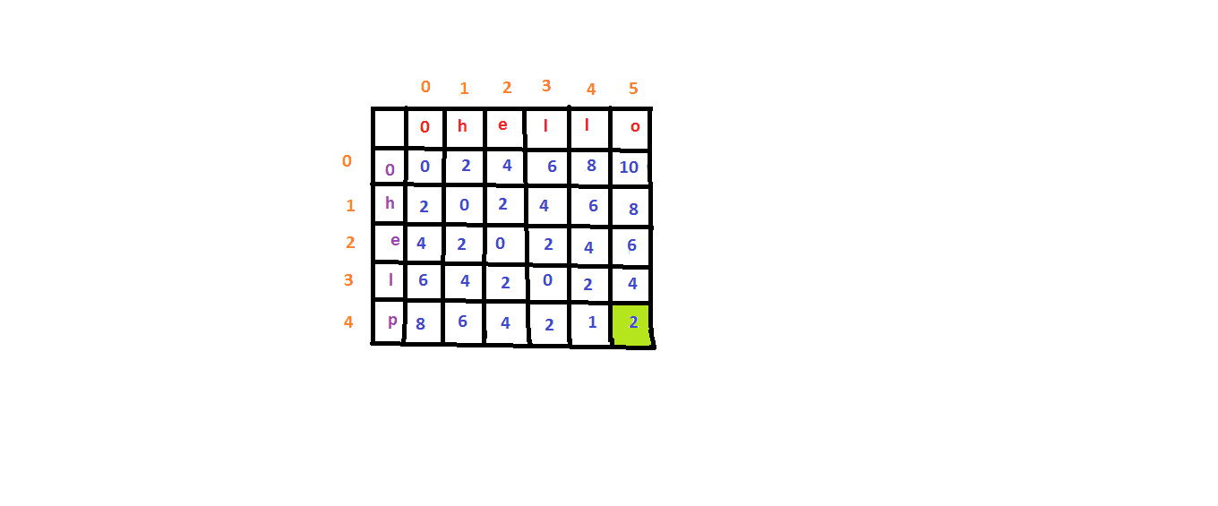

That's what I have tried:
Is it right? If so,is the cost $T[5,5]=10$?Or don't we have to take $T[n,n]$ as the minimum cost of the conversion? (Thinking)
I don't quite understand your table.
Can you explain? (Wondering)Anyway, the most obvious ways I can think of are:

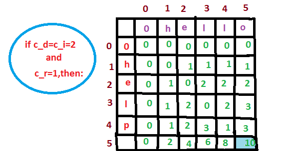

I understand... I tried to create a matrix for $T[i,j]$ using the formula:
$$T(i,j)=\min \left\{\begin{matrix}
T(i-1,j)+c_d & \text{ // delete the i-th charachter of A}\\
T(i,j-1)+c_i & \text{ // insert the j-th charachter of B} \\
T(i-1,j-1) & \text{if } A=B[j]\\
T(i-1,j-1)+c_r & \text{if } A \neq B[j]
\end{matrix}\right.$$
but there is no cost,if we don't make any changes at a position,right? So, the cost doesn't increase , when we keep "hel" ..Or have I understood it wrong? (Thinking)

You have understood it right. Keeping "hel" does not incur any cost. (Nod)
So let's take a look at your table.
We start with T(0,0) which is indeed 0, since nothing is done.
Looking at T(0,1) means we have inserted character 1 of B into A with the cost of 2.
So I think T(0,1) should be 2... (Thinking)
I see you do have T(3,3)=0, T(4,4)=1, T(4,5)=3.
I think the total cost would be T(4,5)=3, since A has 4 characters and B has 5 characters.

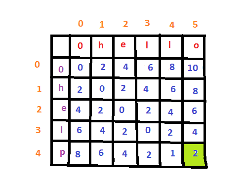

I tried it again..Tha's what I did:
Is it right now or have I done something wrong? (Thinking)

I think the final T(4,5) value should be 3... (Worried)
Because of the fact that we have to insert o and replace p by l,right? (Thinking)
Yes. Actually we have 2 paths to the same result.
Either we replace first and insert afterwards.
Or we insert first and replace afterwards.
Both of them add up to 3. (Nerd)

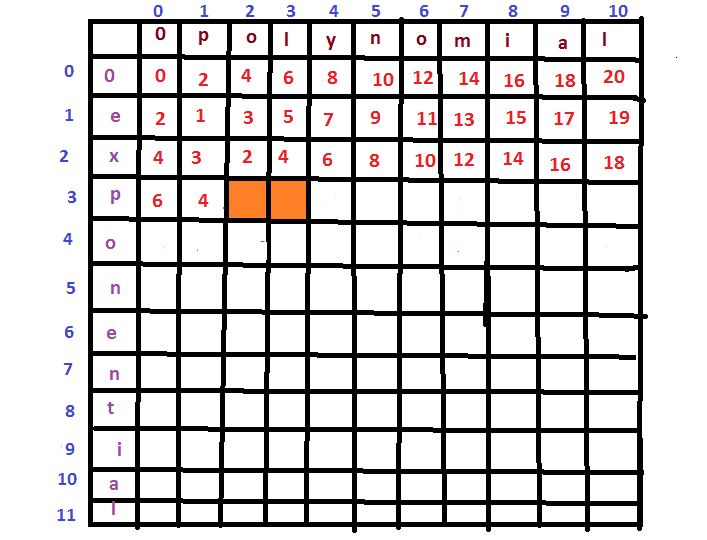

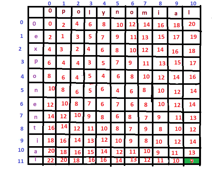

I tried to find the cost,in this case :
Could you tell me if it is right or if I have done something wrong? (Thinking)
Is the cost $T(11,10)=9$ ? (Thinking)

I've started with the path where we simply replace all characters and finally delete the last.
In T(5,5) we have indeed 4 replacements.
How did you get T(6,6)=6?
Shouldn't it be 5? (Wondering)As for your final T(11,10)=9, shouldn't it be at least as high as the lowest of the 3 squares left and above? (Wondering)The last 3 letters "ial" are identical.
So I would expect they could remain the same without cost, but in your table the cost seems to go up as if they were replaced. (Worried)

I like Serena said:
As for your final T(11,10)=9, shouldn't it be at least as high as the lowest of the 3 squares left and above? (Wondering)The last 3 letters "ial" are identifical.
Oh yes,you are right! (Nod)
So..to calculate T(11,10) , do we have to do the following?
replace all the letters from e till o,keep "n",replace e,n,delete t and keep "ial".
So,the cost is 4+2+2=8.
(Thinking)

I like Serena said:
But if we replace all 6 letters, except 'n' because it's the same, wouldn't we have a cost of 5? (Wondering)
Oh yes..you are right! (Wasntme)
So,everything is wrong from T(6,6) till the end of the row,right? (Thinking)
I like Serena said:
I think so! (Nod)
Great! (Cool)
And also on the rows that come after I'm afraid. (Doh)
