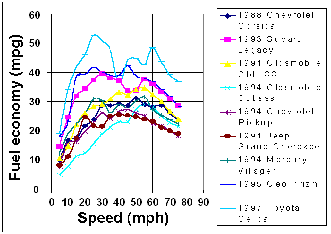

The part that I roughly understand:
1) Drag equation, drag increases by square of velocity, thus if it was only factor to be taken into account then the lower speed the better.
2) In case of cargo ships there is a policy of decreasing speed to reduce fuel usage, called "slow steaming". It became really trendy during recent crisis as there was excess transport capacity and very price conscious clients.
3) Actually for cars the fuel efficiency picture shows also problem of too low speed:
OK, so my question:
-why low speed reduce so drastically fuel economy of contemporary designs?
-if one wanted to design a car that works perfectly fine (or even better) with low speed, how should be the engine (?) redesigned?

Change the gear ratio so that the engine is running at optimal RPM for whatever speed it is doing.

The problem with fuel efficiency at low speeds for cars is not so much the speed, but that in urban areas where cars are obliged to go slow, there is a lot of stop-and-go driving, which tends to drive down the fuel mileage of even the most efficient designs. If your car is idling while stopped at a traffic signal, or while you are stuck in a traffic jam, even the most efficient engine registers 0 liters per km or miles per gallon.
Alleviating congestion, unfortunately, is one problem which even the most talented engineering can do little to overcome.
The gear is an important point. The engines have some RPM range where they have their best efficiency (RPM is related to the timing in the cylinders). Friction in the engines doesn't depend so much on what happens outside, so you have some consumption "liters per hour". That ruins the efficiency if you are too slow.

To be faster, you need more fuel per time. That is obvious. The ratio "fuel per distance" is not that obvious, when you are faster you also make more distance per time.
You can model this as two pieces to the fuel consumption. The first part is simply proportional to the time the engine is running. If you go slowly, this part will dominate. The second part is a function of how fast you are going. If the second part is linear, the mileage goes as a/v + bv.
That model works surprisingly well at fitting the data.

This brings a very challenging question. I have not researched this heavily however I have worked on several hybrid and Composition drive experiments. My initial assumption would be that the lower efficiency peak is closer to the actual peak if one was only dealing with the aerodynamic efficiencies. The upper peak would be closer to peak efficiency of the engine and drive train.
Engines have a relatively narrow band where they are able to be efficient. The entire rest of the range where they are driven we are forcing them to operate outside of their inherit peak. The most common and relatively effective direction chosen is to allow lower speed aero efficiency and pursue higher mechanical efficiency where the people want to drive. The hardest job you will ever encounter is combatting the "group think" that faster is better. this is a public perception and not a mechanical design issue. The people will often override your good design when it does not suit them.
I know this is a long way round to answer your questions however, The best efficiencies I have ever been part of were slow speed vehicles. This was coupled with an engine that was tuned to produce peak power at its peak efficiency. The engine was used directly to drive a generation plant for storage. The energy that was stored was used directly to drive the vehicle. Down sides being it was a heavier drive train (possibly overcome by modern technologies), it spooked the drivers ( when the engine starts and stops on it's own and "races" it is just plain weird), and the efficiencies suffer at higher speeds.
This must be contrasted to the results. In one particular the 4500 lb. test bed vehicle achieved 84 mpg in city driving which was partly due to efficient regenerative braking. The same vehicle only achieved 45mpg on highway at 55 miles per hour.
Your initial post queried what kind of drive train redesign would be needed. It is my thought that a small displacement engine. One that was highly tuned and as efficient as possible at generation direct to storage( probably electric but hydraulic storage is also possible) supplying a drive train that can run efficiently at slower speeds would provide the best results. I would then add a feature on the dashboard. When the driver started to exceed that best efficiency zone it would warn that peak efficiency was no longer possible. Some or many of modern drivers would adhere the rest already know they are not fuel efficient. This would then provide your goal and their choice.

A general purpose car needs to be able to travel at highway speeds (one Texas toll road has a speed limit of 85 mph), while going up moderate grades. That requires a power to weight ratio that results in an engine that's inefficient at speeds below 20 mph. Hybrid cars get around this by having two engines, one electric, one gas, a battery to store energy, and regenertative braking. For a hybrid car running at low speed or low power mode, it can run off the electric engine and battery, cycling the gasoline engine on and off to recharge the battery while running the gasoline engine at an efficient power output. The gasoline engine and electric engine can both run at the same time for increased power for a short period of time, with the combined power of the gasoline engine and the battery (at it's maximum discharge rate).
