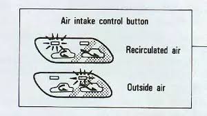

Lnewqban said:
some amount of air must be forced out or exhausted in order to make room for outdoors fresh air coming in.
I've never located that on any car I've owned. I found :
My first car was a hand-me-down Pontiac Catalina 2-door. The air flow on that was under the rear fixed bench seat (there was a raised lip to keep things from rolling under it but it air was free to go over it.). From there it went into the trunk and then forward in the gap between the inner and outer sidewalls of the car. When you opened the doors you could see small black plastic grills near the lock thing. If you looked closely through the grill, behind it was another level with small rubber vanes that would be closed normally but blow open when there was air flow. The air then left the vehicle via the small gap between the door and the fixed part of the body. No doubt that the car moving along would create a suction which helped things along.
Likes Lnewqban
What Lnewqban means is that you can't replace, or, better said, refresh the car, if there is not a flow of air. I may be misunderstanding something, because I am not native; or loosing background, because haven't read the whole thread😏
Likes Lnewqban
