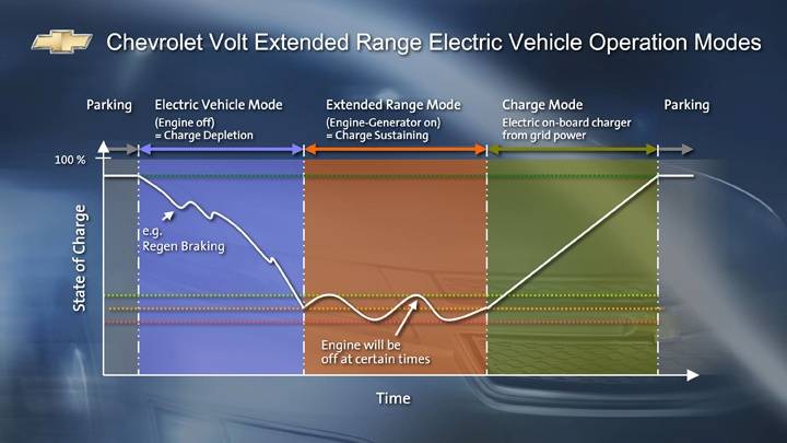

Yes. This type of hybrid is called a series hybrid. The Chevy Volt is a series hybrid which differs from current hybrids like the Prius which is a parallel hybrid. A series hybrid does offer many advantages over a parallel hybrid in that it is theoretically more efficient since the engine can operate at peak efficiency all the time as russ stated. You also save some weight in the drive train area but need a bigger more robust electrical power train.
The main reason for the lack of series hybrids is cost. Big electric motors, inverters/converters and batteries cost a lot more than an ICE engine. The biggest advantages are efficiency and simpler "plug in" operation. Series hybrids generally go a lot further (and faster) on battery only power due to a bigger battery.
If you want remove the battery and have the ICE and generator power an electric motor you will be taking a hit in efficiency. An entire engine plus electric powertrain will not be as efficient as just a typical ICE engine. Not only is the efficiency less but the cost will also be much higher.

The http://en.wikipedia.org/wiki/Chevrolet_Volt" battery pack has nothing to do with the system the OP is referring to. It could be seen as another system, in parallel (not in series) of the one under discussion in this thread. Yes, the Chevy Volt has an ICE-powered generator connected to an electric motor. The car could theoretically work by itself just with that system. The engineers have just put an extra externally rechargeable battery pack that is used to power the vehicle for the first 40 miles (64 km), satisfying the daily commute for 75% of Americans, hence completely eliminating the use of an ICE. The ICE takes over after that, operating at its peak efficiency all the time, because it is physically unconnected from the wheels, just like I've mentioned before. Looking at efficiency alone, removing the battery pack wouldn't make it pointless to use the system, i.e. a CVT.

The Chevy Volt's drive train operation is more complicated than 'E-motor for some miles, deplete the battery, then run all engine.' Yes the Volt will run in an e-motor/battery only mode when the battery has ample charge, but the battery is never allowed to fully deplete. Once the battery reaches 30% charge or so, the motor kicks on/off intermittently in 'charge-sustaining' mode, allowing the gas engine to run only at a peak efficiency set point, as Russ suggested above. Also, as others have mentioned, the battery allows regen braking energy capture, though I doubt regen braking saves as much energy as allowing a reciprocating engine to run only at its peak efficiency point.
