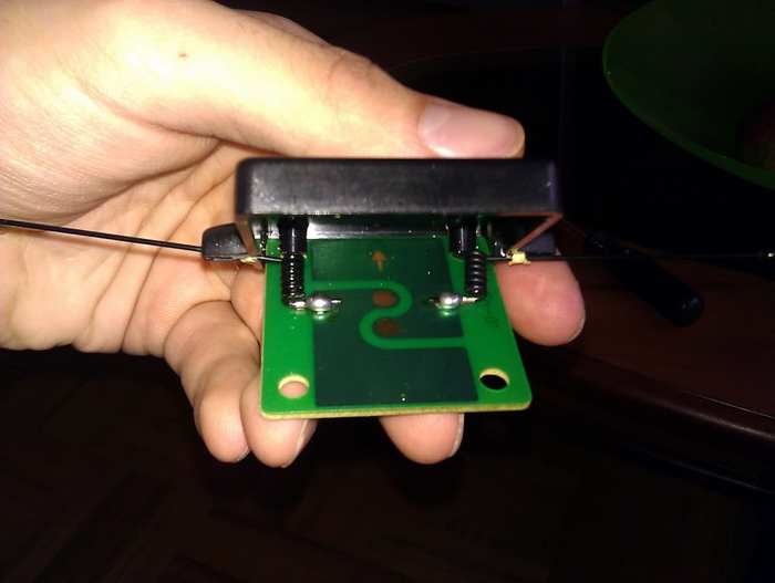

Could somebody help me identify this odd device?

In summary, this object is probably some sort of EMF cancellation device or reflector meant for use with a phone or other electronics. It appears to be poorly built and probably not very effective.
jadamczyk
Now, I'm not very well versed in the engineering side of telecommunications and what-not, so i was wondering if somebody could tell me what this was, I've exhausted all other options. It was glued to a window when my uncle moved into his apartment. The black box is the size of a matchbox roughly. I have no idea what this could be apart from possibly an rfid or something.
Thanks in advance.
Just wanted to add, there's no spot for a cable or anything to connect to it, and no circuitry except for the odd copper shape in the middle.
Are the "antennas" even connected to the copper, or are they just sitting on the silkscreen? That's a piss-poor soldering job there, anyhow.
Barring some obscure use that I don't know about, I'd hazard a wild guess that it's some sort of "EMF cancellation" piece of garbage that you'd sell to people who want something fancier and less obviously loony than a tin foil hat, if you catch my drift.
BTW, please put images that big in spoiler tags or reduce them so they don't screw up the layout.
It could just be garbage or, on the other hand, it could be a tuned reflector - a sort of passive bug that would give a 'good' reflection at its resonant frequency. Those inductors in series with the dipole elements and the capacity plates (?) could be tuning elements. It would depend on the quality of the build.
I wouldn't say the soldering was poor- it appears to me that the inductors are soldered to vertical pins which are already in the board. What's on the other side of the board (is it double sided or are those shapes we can see on the underside) and up inside the lid of the box?

Thanks for the detailed replies guys. On the other side of the board there is just a rectangle in the middle, no copper portions. There is nothing inside the black housing, i just pulled the board out of in for that picture but couldn't fully get it out since the antenna were glued to the plastic, that's why it looks kind of weird in that picture.

If this is a 'real' piece of kit, it could either be to act as a reflector at a certain frequency - or some sort of passive way to increase the local level of some signal - say Wifi. Either way I can't see it being very effective - except as a source of income for the manufacturer and seller.
From the component sizes,it would probably work at around 1GHz.

With the copper spaced that far apart, wouldn't the capacitance value be super, super small?
I don't see any vertical pins in that solder blob, it looks like it's just "hot glued" to the silkscreen with a blob.
You could well be right about the soldering but it looks too neat to me and just what would those plates be made of if not copper beneath some green lacquer. Perhaps they're soldered to two circular holes in the lacquer . The capacity between those plates would only be a couple of pF. which would resonate with a few nanohenries (?) at several hundred MHz.

Perhaps it was meant to couple signals from a device inside the window to the antenna outside the window. The coupler portion inside the window would capacitively drive the two plates differentially...

Yep. You got me thinking of the old cell phone "through-glass" antenna couplers and found this.
and this.

But yeah, now I'm wondering how it works. I'd assumed that there was a coax feed to a differential balun that was glued to the inside of the glass, but the info on the package and at www.Callet.com calls it a "Passive Repeater". So somehow it resonates with the cell in the house/car, and helps to get the pattern better outside the house/car?

Actually, it's http://www.cellet.com/catalog/product.php?productid=12024&cat=320&page=1" .
Back in the day I had one that was made with a coax input but this one has an antenna input.

Extends the transmitted and received signals of mobile/cell phone antenna.
Provides improved signal strength in areas where cell phone signal is weak.
Easy stick-on installation – no drilling, no tuning, no set up and nothing to hook up.
Passive-repeater circuit board reduces signal loss, cutoff, fade and static.
Picks up signals from your phone and transmits them outside, pulls in signals from outside for improved reception.
Boost your cell phone reception in the car with this Passive Antenna Repeater. “Passive” antenna repeater works like an additional antenna for your cell phone by extending both the transmitted and received cell phone signal to reduce dropped calls. Antenna repeater works passively so it requires no drilling, tuning, wires or set up. Simply stick on the antenna to the outside of rear windshield and stick on the antenna base to the inside of rear windshield. Works with all types of cell phone frequencies and networks and all types of cars, trucks, SUVs and RVs.
http://cellphone.rlstuff.net/cellet-car-mount-passive-antenna-repeater-acar3a/"
Oh, I get it now. The two pieces go on opposite sides of the glass. Duh.

Wow, you guys solved the mystery. Thanks so much. Who would've thought that it would turn out to be something so obvious. Come to think of it, when i asked my neighbour before posting here, this cell phone antenna thing was the first thing he suggested but i blew off the idea :P
Now that we know exactly what is is, thanks to dlgoff's link, the next question is: Does it even do anything?
Since it's completely passive, it can't actually give any power gain. Resonance can, at best, increase the efficiency to close to 100%, but it can't magically pull free power out of its aether.
