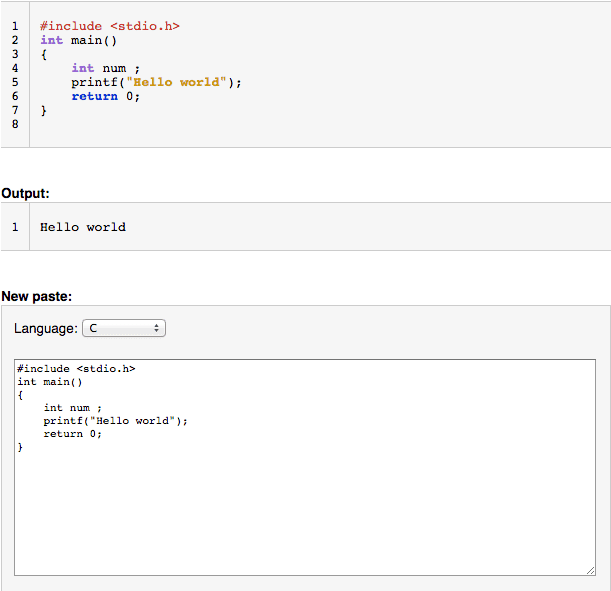

I should point out that I am very new to this but want to learn more and more about C.
And no that project is not easy for me.
I was able to make the basic "hello world" program, when searching the web
#include <stdio.h>
int main()
int num
printf("hello world")
return 0;
So I was able to compile just fine.
However, even that I don't fully understand what's going on to make it print out Hello World.
Why #include <stdio.h> what is that? what does it mean?
Why int main()?
why the brackets
why int num;?
Print makes sense as it's the purpose of the program. but why f? and why return 0;
Is that sort of like saying there is nothing more to do here.
I think I understand the brackets as to mean Opening and Closing of a program/function/operation?
Why does any of that exist and in that order?
And could I have a hint for the program asked not sure how to go about it
THANK YOU!

You are asking us to answer all of the basic questions about language syntax. You need to study this stuff on your own. LOOK UP what they each mean and do and then apply them in VERY simple cases to make sure you understand them, and then come back with questions that you still have.
Likes Medicol and mafagafo
It will take an inordinate amount of time and effort to learn a programming language by "searching the web", especially if, as I suspect the case is here, it is your first programming language, when this will most likely simply fail. Get a book. Or find a tutorial on the web. Either way, stick with it and follow it methodically. Do not go for random examples.

This begs the question: why are you learning C in the first place? If you're learning out of personal interest and you're new to programming in general, you're probably better off starting with a more beginner-friendly language like Python. The "hello, world" program in Python is just one line long:
Python:
print("hello, world")
#include <stdio.h>
int main()
int num
return 0;
As phinds pointed out above, most of the questions you asked about this program would be fairly quickly answered if you read a good book or tutorial on C, which you should really be doing anyway if you want to learn C.
There's just one exception that's worth mentioning to save you any future confusion: the "int num;" line in your example program is redundant. It declares an integer variable that the program never uses. The minimal "hello, world" program in C is just
C:
#include <stdio.h>
int main(void)
    puts("hello, world");
    return 0;
