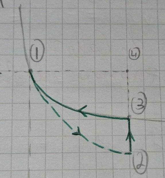

Could someone help me study this cyclic process of an ideal gas?
In this discussion, participants analyze a cyclic process involving an ideal gas, focusing on calculating the system's entropy change (ΔS), total work done, and the surroundings' entropy change. They establish that ΔS for the system is zero over the complete cycle, but recognize that during the irreversible adiabatic step, the system's entropy must increase. The total work done is derived from the net work across the three transformations, with specific calculations for each segment. Participants debate the nature of heat transfer (Qh) and its implications for the surroundings' entropy changes, ultimately concluding that the total entropy of the universe increases slightly due to the irreversible process. The conversation emphasizes the importance of understanding the distinctions between reversible and irreversible processes in thermodynamics.
Thermofox
144
26
##0.5## moles of an ideal gas, at ##P_1= 1atm## and ##T_1= 20 °C##, go through the following cycle:
From 1 to 2: irreversible adiabatic;
From 2 to 3: reversible isovolumetric;
From 3 to 1: reversible isothermic.
In this cycle the system absorbs ##Q_h=890J## and ##V_2 = 3V_1##
##\Delta U = W + Q##
I need to determine:
1)##\Delta S## of the system
2)Total work done by the system
3)##\Delta S## of the surroundings
For point 1 ##\Delta S_{system}=0## because it is a cyclic process.
For point 2 ##W_{net}= W_{1-2} + W_{2-3} + W_{3-1}##.
Since 2-3 is an isovolumetric process, ##W_{2-3}=0##
=> ##W_{1-2}= \Delta U= nc_v\Delta T_{1-2}## and ##W_{3-1}= -ln(\frac {V_1} {V_3})##.
I'm not sure about point 3 though. Because surely ##\Delta S_{1-2}^{surr.}= 0## since in the process there is no heat exchange between system and surroundings. But I don't know how to determine the change for the other 2 transformations. I assume I should be using ##Q_h##, that in this case must be all absorbed during 2-3, but still I don't know how to proceed forward.

The work from 3 to 1 has to be negative. Check what you write.
If Q = 0 for an irreversible process you can't conclude that ΔSsys = 0 for that process.
That would only be true for reversible processes.
To me it's not clear what is meant by irreversible, adiabatic. Does it just mean Q = 0, or does the process follow the adiabatic curve in the pV-diagram? If the latter is true you can calculate W immediately (with one extra assumption).
What is Qh? Is it the total heat transfer during one cycle or it just the heat going from the surroundings to the system?
If I'm using ##\Delta U= W + Q## then mustn't a compression mean positive work? The work is
##W_{3-1}= -ln(\frac {V_1} {V_3})nRT= -ln(\frac {1} {3})nRT##, because ##V_3=V_2=3V_1##

I would go for ΔSsurr 1-2 = 0 since no heat enters or leaves the surroundings and, by definition, the surroundings are unchanged.
The other two processes are reversible so they're you know ΔS for the surroundings.
Can you tell me how to find ##\Delta S_{surr,2-3}## and ##\Delta S_{surr,3-1}##, because I can't see it.
You know that the heat for the cycle is 890 J and you know the work for the isothermal reversible step. The change in internal energy for this step is zero, so that means that you know the heat for this step. You also know that the heat for the irreversible step is zero. This all then tells you the heat for the constant volume step.
Both those steps are reversible so for each of them the entropy changes for system and surroundings add up to 0.
Is that what you needed?

Thermofox said:
But now I get a negative change in entropy, shouldn't it increase?
In total for system and surroundings it should increase.
For the 2 reversible processes it stays the same in total.
For the first process ΔS = 0 for the surroundings, whereas for the system the entropy should increase.
How do you calculate the system's entropy change during the adiabatic expansion?
Let’s see some numbers.
Philip Koeck said:
How do you calculate the systems entropy change during the adiabatic expansion?
I thought of breaking up 1-2 into 2 processes, an isovolumetric and an isobaric one.
=> ##\Delta S_{1-4} + \Delta S_{4-2} = \Delta S_{1-2}##
Okay. What do you get?
Where does point 4 come in and why?
Point 4 as the same pressure of point 1 and the same volume of point 2( and 3). I used it so that I could determine ##\Delta S##. Otherwise I don't know how I could determine ##\Delta S_{1-2}##
An isotherm and an isochor (isovolumetric) would be another option.
##T_4= \frac {P_4 V_4} {nR}= \frac {(1)(36.1)} {(0.5) (0.0821)}= 879,4K##, I found V_1 in the same manner.
=> ##\Delta S_{1-4}= nc_p ln(\frac {T_4} {T_1})= 0.5 \frac 5 2 ln(\frac {879,4} {293.16})= 11,41 \frac J K##
Since 1-2 is adiabatic, ##T_1 V_1^{\gamma - 1} = T_2 V_2^{\gamma - 1}##
=> ##T_2= T_1 (\frac {V_1} {V_2})^{\gamma - 1}= 293,16(\frac 1 3)^{\frac 5 3 - 1}= 140,9(K)##
##\Delta S_{4-2}=nc_v ln(\frac {T_2} {T_4})= 0.5 \frac 3 2 8,31 ln(\frac {140,9} {879,4})= -11,41 \frac J K##
=> ##\Delta S_{1-2}= 0## but it should be greater than 0, maybe it's because of how I determined ##T_2##?

Q_{2-3}=Q_h
=> ##Q_h= nc_v \Delta T= 0.5 \frac 3 2 8.31 (T_3 - T_2)##, hence $$ T_2 = \frac {nc_vT_3 - Q} {nc_v}= 150.36 \frac J K$$
If I use this temperature I obtain that ##\Delta S_{4-2}= -11\frac J K##
=>##\Delta S_{1-2}= 0.41\frac J K##

That sounds right to me.
  • #32
This means That the entropy of the universe increased by 0.41, right?
I found ##\Delta S_{2-3,sys}= 4.16 \frac J K## and ##\Delta S_{3-1,sys}= -4.56\frac J K##
If I sum them I obtain that ##\Delta S_{sys}=0.01 \frac J K##, but I think I can consider this as an error of approximation.
Moreover does this mean that ##\Delta S_{surr.}= - \Delta S_{sys,2-3} + (-\Delta S_{sys, 3-1})= -4.16 + 4.56= 0.40 (\frac J K)##?
  • #33
Yes that sounds reasonable.
Without rounding errors the entropy for the system should be unchanged after one cycle, whereas the entropy of the surroundings should have increased (by about 0.41 J/K)

Philip Koeck said:
I have a follow-up question (also to @Chestermiller):
W1-2 has to be the same as -Qh so that ΔU becomes zero for a complete cycle.
If, however, I insist on calculating W1-2 as Pext ΔV I'm a bit stuck.
With Pext equal to P2, the internal pressure in state 2 (which seemed the obvious choice to me), I get only about half of -890 J.
Surely Pext can't be higher than P2.
Unless you know ##P_{ext}## explicitly for an irreversible expansion or compression, you can not determine the work (without solving the internal Navier Stokes equation, the continuity equation, and the differential thermal energy balances equation simultaneously).
