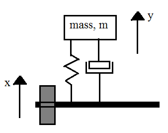

I was asked to draw a Simulink Model for the above (car suspension) system.
m = 250kg
k, spring constant = 70000N/m
c, damping coefficient = 3000N/m/s
If any equations are needed please let me know
The question says to draw 3 Simulink Models having separate types of input (step, ramp, impulse)
The diagram above shows the Simulink Model for the Impulse Input
It would be appreciated if someone could check my Model and tell me of any short comings. Thank you.
a constant input of 1 is not an impulse. there is a step and ramp input you can use. To create the impulse response you need to get creative. As a hint, try using 2 step response blocks, and slightly delaying one of them
its been a while since I have worked with mechanical systems like that. on account of me being lazy, if you give me the equations, I can check your simulink diagram assuming the equations are correct.
Many thanks for you reply.
Yeah I got the step and ramp, I was having a little bit of trouble with the impulse, but I will try to do what you told. Thanks for the hint.
The differential equation I got, and the simulink diagram was modeled according to:
y''(t) = (1/m)(x - ky - cy')
The simulink model is exactly the same except ramp and step inputs instead of the constant input in the original post
