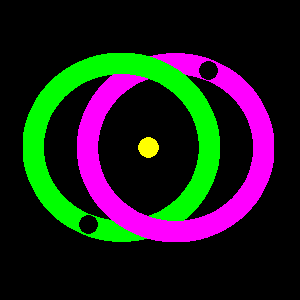

I met a question when I try to solve a twin-planet problem in "Classical mechanics" by Goldstein 3rd edition. Chap3-17. As followings:
One of the classic themes of science fiction is a twin planet (“Planet X”) to Earth that is identical in mass, energy, and momentum but is located on the orbit 180° out of phase with Earth so that it would be hidden by the Sun. However because of the elliptical nature of the orbit it would not always be completely hidden. Assume there is such a planet in the same Keplerian orbit as Earth in such a manner that it is in aphelion (furthest from the Sun) when Earth is in perihelion (closest to the Sun). Calculate to first order in eccentricity e the maximum angular separation of the twin and the Sun as viewed from Earth. Could such a twin be visible from Earth? Suppose the twin planet were in an elliptical orbit having the same size and shape as that of Earth, but rotated 180° from the orbit of Earth, so that Earth and the twin would be in perihelion at the same time. Repeat your calculation and compare the visibility in the two situations.
Would you like to give some hint to solve this problem?
I will be very appreciated for your great help.

Scenerio 1: Angular separation will occur (eccentricity and sizes exaggerated):
http://orbitsimulator.com/orbiter/PlanetX1.GIF
Scenerio 2: Angular separation will not occur (eccentricity and sizes exaggerated):
http://orbitsimulator.com/orbiter/PlanetX2.GIF
The twin planets will always have a Mean Anomaly 180 degrees apart (Mean Anomaly could almost be thought of as identifying the objects location in the orbit by time). The better way to identify their position is by radians - they're mean anomalies are always pi radians apart.
The maximum difference in Eccentric Anomaly (in radians) will equal the eccentricity of the orbit. (M=E-e sin E). It will occur when Eccentric Anomaly is pi/2 radians (90 degrees) or 3pi/2 (270 degrees) [absolute value of the difference].
Since the Earth's orbit around the Sun has an eccentricity of .0167, the maximum difference between Eccentric Anomaly and Mean Anomaly is .0167 radians, or .0167*pi/180 degrees.
You technically have to convert the Eccentric Anomaly to True Anomaly to find how far apart True Anomaly and Mean Anomaly are. But, with an eccentricity of only .0167, you can safely say that both objects will be offset from Mean Anomaly by a maximum (absolute value) of about 1 degree. Your eccentricity has to be pretty high to get big differences between Eccentric Anomaly and True Anomaly - the tangents of the half-angle of the two are related by [(1+e)/(1-e)]^(1/2)
Both will hit maximum at the same time - one positive and one negative. That gives you a 1-1-178 triangle (approximately). Your maximum separation is very close to .0167*pi/180, or slightly less than 1 degree. The Sun's apparent width is about 0.5 degrees, .25 degrees either side of the direct line joining the center of the Earth and Sun.
The twin planet technically lies in the line of sight of the Earth (but, as Tony said, it would be too close to the Sun to be visible to the naked eye).
