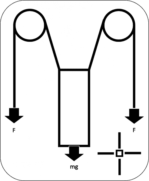

just wondering with development in modular robotics, could we possibly throw a space station into space bit by bit via something as simple as a pulley system?
doing a bit of research i found out you can get a 1000 ton crane, therefore 9,800,000N of force, i also found out that if we can throw something upwards at 11,000 m/s it will never return back to earth. aka. its in space.
so using the v2=u2+2as
and a simple pulley system equation, F-mg = ma
we can come to, s=v2m/2(F-mg)
substituting values into this, F=9,800,000N, m = 10kg (if we send stuff up in 10 kg packets) and v=11,000 m/s
we get s=61.74m
now if we set up 4 of these pulleys in a cross section like the bottom corner of the attached image. we can cut that down by a factor of 4.
so what I am saying/ asking why couldn't we throw stuff up into space using a contraption 15.43m or so tall?
i feel as if i might be missing something simple here, i am only a high school student so please could you give some feed back about this, i would love to learn more about it, thanks.

Cranes use hydraulics and extreme reduction gearing to support their loads. They aren't physically capable of moving anywhere close to that fast -- they are so far on the opposite end of the spectrum you may as well consider them fixed towers! So while it can apply 9.8 MN to a 9.8 MN load, that doesn't mean it can apply 9.8 MN to a 98N load.
A catapult kind of mechanism that you are suggesting would impart enormous acceleration to the projectile over a very short amount of time.
Enough to achieve Earth escape velocity in a few seconds, and a bit more as well to deal with the atmosphere problem.
The risks involved in engineering such a catapult seem a bit high to me, and it could not be used for launching humans, the G forces on the body would make death almost certain.
Rockets are probably a better bet.

Have you really thought about what escape velocity looks like? I mean, you listed the numbers but have your really thougth about it? Remember, this is a purely ballistic trajectory, so you have to obtain escape velocity by the time your payload leaves the launch mechanism. That means it has to travel 7 miles in the first second so if you had, for example, a 7 mile rail gun, the payload would have to traverse the entire 7 miles in one second. You really think you are going to get something moving that fast with a crane or a catapult?
kieyard said:
how about a 1000 ton press? presses tend to move much faster than cranes?
I'm not so sure they do. They are still hydraulically operated.
Also recognize that if the device is accelerating a payload, the force has to be accelerating the parts of the device connected to it as well. For a standard crane, that means linear acceleration of the cable and angular acceleration of the spool of cable.
Try another calculation: the moment before release, when still applying 9.8mn and the payload now traveling at 11 km/s, what is the POWER output of the device? Compare the answer to, say, the average nuclear power reactor.

okay, if the power of the crane remains the same it could achieve a higher speed if it reduces the force, right? we could simply increase the height of my catapult (as people have been calling it) and/or reduce each payload. meaning more time to accelerate and less force needed to accomplish escape velocity?
Correct.
At a rough guess though, the height of your of the catapult, (or whatever name is best for it) will need to be in the order of tens of kilometers.
A cable strong enough to support 10 MN of force, with a mass of just 10 kg, cannot be longer than two or three meters. And that does not even include the mechanism to accelerate the cable, which simply does not exist at the required speed (its mass would contribute as well).
The simple pulley system shown in the first post would give a maximal acceleration of 1g = 10 m/s2, clearly impractical to reach high speeds. Most of the energy released would just go into accelerating the weights at the sides (=they just fall down).
