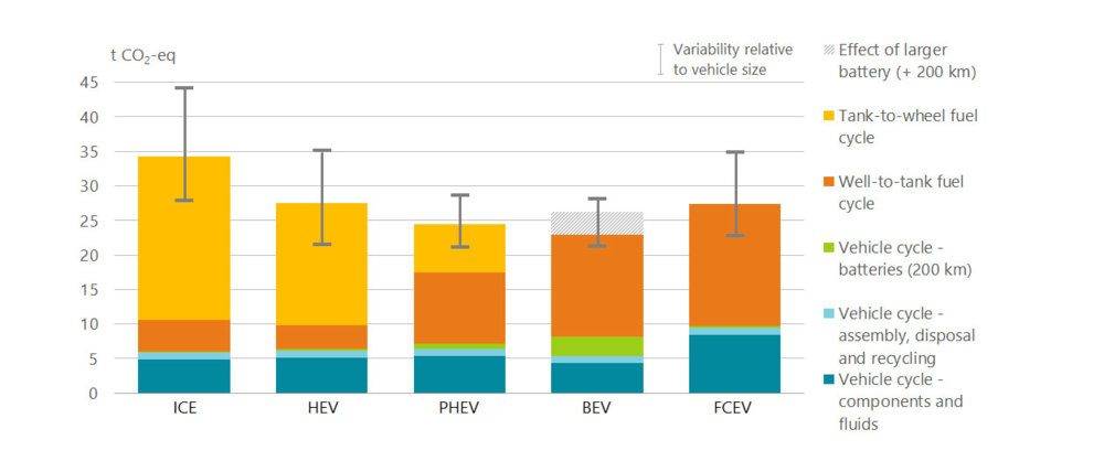

The offset to the CO2 generated during the battery recharge is that the overall internal combustion energy efficiency is abysmal, well under 10% for cars. That gives battery powered vehicles a huge leg up, even if the charging process is inefficient.
  • #35
No, most cars are on the order of 20-25% efficient, with peak thermal efficiencies on some modern engines getting up into the 40s.
