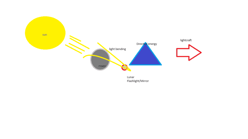

Not the reflection of the moon's light, rather i meant the sunlight that is bent around the moon in space.
I'm thinking of it as if a mirror in space is positioned as if the earth is during a solar eclipse and that is directed toward the lightcraft. Again I know nothing, thank you for the knowledge.

I don't understand what you're getting at. Can you sketch what you have in mind? You can add images to posts with the "Attach files" button below the reply box.
Sorry im not good at illustration

What makes you think that sunlight "is bent around the moon in space"? The moon lacks sufficient atmosphere and gravitational pull to bend light to any noticeable degree. Instead, it simply casts a shadow.
Gravitational lensing and general relativity as i understand it says that all objects with mass bend and warp space and light around them. And so i thought about how that works with the moon and if using something as large as a planet to reflect such a light source would amplify or even simply make it easier to direct towards a lightcraft

It takes a huge mass to bend light by any noticeable amount. For example, a ray of light passing just over the surface of the Sun is only deflected by 1.7 seconds of an arc. (1 sec = 1/3600 of a degree). This means that the "focus point" where light passing near the Sun would converge is some 14 times the distance Pluto is from the Sun. Now keep in mind that the Sun is some 27 million times as massive as the Moon.

Beaten to it, I see, but there's basically no gravitational lensing around the Moon or any planet. They're just way too small and light to do any significant lensing.
