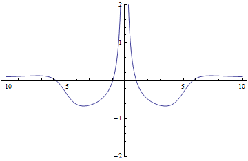

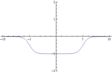

This does happen with protons as well, but yes, it is far more likely to happen to a neutron in a heavy nucleus, and the reason for it is higher potential barrier for the protons. Yes, it's counter-intuitive, but actually pretty straight forward. Consider nucleon potential of this form. (I made up the shape, but it's qualitatively correct.)
For neutrons, this is all there is. For protons there is an additional repulsive potential. Let's just throw in a 1/r from center. It's not quite right at the center, but we are only interested what happens near the edges of the nucleus.
Certainly, the energy difference between the ground state and barrier for protons has only decreased. But we aren't interested in a proton or neutron in the ground state of this potential. We are interested in protons and neutrons with the highest energy in this nucleus.
Why is it that heavy nucleons have much higher number of neutrons than protons? Because a nucleus with same number of both would have protons with much higher energy. That results in protons undergoing beta decay and becoming neutrons. If there are any protons with significantly higher energy than neutrons, there will be beta decay.
That's where things start getting interesting. The energy of the most energetic proton and neutron are going to be roughly the same. The potential energy for protons, however, has increased everywhere. That means that relatively to the highest point of the potential barrier, your most energetic proton is sitting lower than neutron is sitting relative to its barrier.
In other words, thanks to electrostatic repulsion, the protons are fewer, but because they must have the same total energy as neutrons, they have a higher barrier to overcome in order to escape thanks to their repulsion.

K^2, in your diagram (by your choice of where to draw the zero levels) you seem to be comparing protons and neutrons on the basis of their kinetic energy after they escape to infinity. To me, it makes more sense to compare them on the basis of their kinetic energy at some given radius within the well. Is it not the case during billiard ball collisions that their kinetic energies on average get distributed evenly, without distinction as to what their respective potential energies are (i.e., never minding whether some have springs attached nor electric potential etc)? Or to put it in other words:
Yes, I chose infinity, because it's the least messy choice. You can choose any point you like, but regardless of choice, the neutron and proton potential energies must be different by the coulomb term for the later. Remember, kinetic energy does not depend on choice of zero potential. So this difference must be consistent for your description to be consistent. Since the difference is zero at infinity, it's the natural choice, but you can work it out at an arbitrary point.

To emphasise my point of conflict here, it is that you have shown two plots in which the residual-strong-nuclear component of the potential is identical for both neutrons and protons (i.e., only the coulomb potential differs), and used this to assert that neutrons are always more likely to be ejected. I think what those plots actually show is that in the case of Z=N (as tends to occur stably for calcium and lighter elements) the protons are more likely to be ejected. But for neutrons to be more likely to be ejected, we would need a different pair of plots in which the residual-strong-nuclear component of the potential is stronger for protons than it is for neutrons (as in fact is the case in nuclei with N>>Z due to the inequality of residual-strong forces between same-same and otherwise pairs of nucleons).
