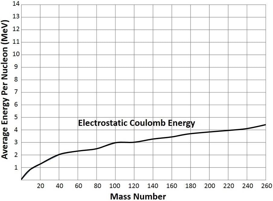

A M said:
This is the reason for the electrostatic repulsion not to grow at an exactly constant rate
It is unclear how you quantify "the electrostatic repulsion" and what you mean by a constant rate, but even with a constant proton to atomic mass ratio nothing would have a rate that could be considered constant.
As I said, diagrams don't correspond precise information. I haven't quantified the electrostatic repulsion; I just want to express that because of its infinite range characteristics and small size of nuclei, the disruptive energy of the Coulomb force increases as mass number grows.
I don't mean a constant ratio of atomic number to mass number; I mean that the disruptive energy [per nucleon] depends on atomic number, and according to the fact that the heavier the nuclei the smaller its ratio of protons to mass number, the disruptive energy grows at a slower (not constant) rate for heavier nuclei.
But if you think there's still a mistake, I would appreciate hearing your thoughts/suggestions. :smile:
Indeed, but the relation is not as easy as your text suggests.
Slower than what? If you use a word that implies an inequality you need to specify what you compare to what. "Grow at constant rate" would be a linear relation, but you don't get anything linear anywhere.
You can look up how the electrostatic repulsion depends on the proton and mass number, and which assumption goes into that formula.

A M said:
the reason for the electrostatic repulsion NOT to grow at an exactly constant rate
Yes, the diagram doesn't indicate a linear relation, and that's exactly what I want; it is due the reason that has already been said.
Ummm, I tried, but couldn't find any formula for the Coulomb force between the protons of a single nucleus. I'm still searching for results.
Thanks!
No, you are making it worse. That's like insisting that a cat does not grow in the same way as an elephant - because it has claws.
I find it hard to believe you didn't find at least the Wikipedia article about the topic if you searched.
Likes A M
Yes, you're right. I'll try to correct this part of my article. I didn't know I should find it in semi-empirical mass formulas. Thanks!

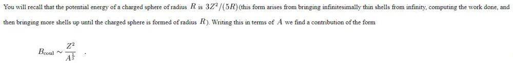

In a bound state like atom nucleus (except ##^{1}H##), protons carry a positive charge so repel each other by the Coulomb force. This type of electromagnetic force, (also referred to as electrostatic repulsion) is an inverse-square force (has infinite range characteristics), so a proton added to a nucleus will feel an electrostatic repulsion from all the other protons in the nucleus.
According to semi-empirical mass formula, the Coulomb energy per nucleon for a nucleus with ##Z## protons and ##A## nucleons, can be calculated by the term ##a_c\frac {Z(Z-1)} {A^{1/3
}}##, where ##a_c## is electrostatic Coulomb constant with an approximated value of ##0.691 MeV##.
The electrostatic energy per nucleon due to the Coulomb force thus grows as nuclei atomic number increases [depending on ##Z(Z-1)/A^{1/3}##]:

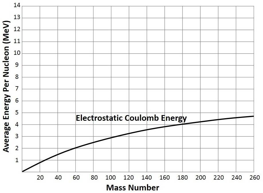

I removed that confusing sentence and added some information about Coulomb term instead. Then I designed a more precise diagram by some calculations. @mfb , would you please let me know if there's something wrong (or confusing, unclear, ...)?
You didn't give a motivation for the formula used, but adding that would add a lot of text.
It is unclear what you used for Z as function of A to make the graph.
Whatever it is, it's smoother than in real life. (Even assuming spherical nuclei)

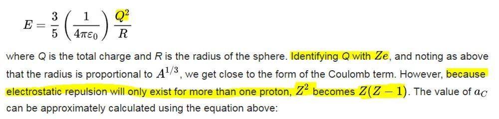

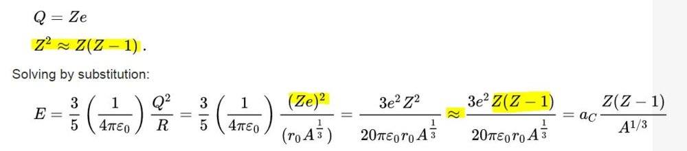

SEMF: Coulomb term
##E_C=a_c\frac {Z(Z-1)} {A^{1/3}}##
Because electrostatic repulsion will only exist for more than one proton, we use ##Z(Z-1)##. But for a more precise calculation, ##Z(Z-1)## becomes ##Z^2## when we know the Coulomb energy for hydrogen is zero. So:
##E_C=a_c\frac {Z^2} {A^{1/3}}##
The Coulomb energy per nucleon of a nucleus, is its Coulomb energy devided by mass number. So, for ##E_C/A## we could write:
##E_C/A=a_c\frac {\frac {Z^2} {A^{1/3}}} {A}##
And according to some sources, the Coulomb constant has an approximated value of 0.711 MeV. Now we could say:
##E_C/A=0.711(Z^2) (A^{-4/3})##
Now, for the diagram, I've chosen consistent mass numbers and found a common number of protons for each of them. So, I calculated the electrostatic Coulomb energy per nucleon of those nuclides, as indicated in the table: (If you don't trust me, you can try them!)
