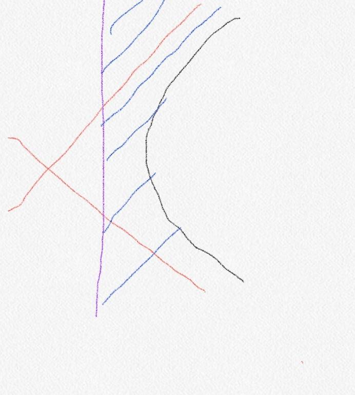

I am afraid my scenario was in failure.
Say rockets of various constant acceleration a>0 approach from X=+infinity, stop at T=0 and X=c^2/a in an IFR and leave toward X=+infinity. The plane X=0 is their Rindler event horizon.
Say there is a charged star at X=-d<0 from enough past to future in the IFR.
The ships cannot observe events in the space time region X > T where c=1. The world line of the star lies beyond the line X=T so some events on the line is not observed by the ship.
The ships, however, do not observe the star and generated em field enter into the horizon. The star stay frozen touching the horizon forever and do not go beyond the horizon. So the horizon itself do not have to undertake charge.
Say a pair creation of charged particles event take place in the space time region X>T. The ships cannot observe at all the charges including generated em fields, e.g. dipole one. Again horizon itself has nothing to do with charge.

Say rockets of various constant acceleration a>0 approach from X=+infinity, stop at T=0 and X=c^2/a in an IFR and leave toward X=+infinity. The plane X=T,-T, where c=1,0 is their Rindler event horizon.
Say there is a pair of positive and negative charges in the IFR. They are at rest and far apart and come closer by Coulomb force. At T=0 space coordinate of positive charge is d>0, that of negative charge is -d. They will collide some time later.
The ships observe motion of positive charge only. Past frozen particle at X=0 comes up, stops, goes down to X=0 and frozen again. The ships also observe Coulomb force applying on the positive charge due to untisymmetry motion of coming up and going down. The ships people would assume that there is negative charge behind the horizon.

At first the rocket's acceleration and velocity vectors point to opposite directions. That causes the rocket to move so that its "Rindler horizon" is leading. And that will result in all kinds of stuff going through the "Rindler horizon". Right?
I put quote marks around "Rindler horizon", because that thing doesn't seem to be a proper Rindler horizon.
Depends on your frame of reference. One can always choose a Rindler observer's velocity to be parallel or anti-parallel to its acceleration.
Note that there are two Rindler horizons. There is a past horizon (##x=-ct## in inertial coordinates centred on the crossing point of the two horizons), which is analogous to the horizon of a white hole, from which things can rise and be seen to rise. There is also a future horizon (##x=ct##) which is analogous to the horizon of a black hole.
Whether or not something passes through a given Rindler observer's horizon(s) is coordinate independent. The Rindler observer's simultaneity planes are such that he always regards the horizon intersection (##x=ct=0##) as "now". So in this Rindler frame, crossing the past horizon always happens "before now" and crossing the future horizon never quite happens.
Likes sweet springs and PAllen
Correction: Not X=0 of the IFR but x=0 for the ships or in Rindler coordinate.

Depends what you mean. Here's a quick sketch of a Minkowski diagram showing a black Rindler observer with a purple inertial observer crossing both the (red) Rindler horizons.
You can see that the blue signals the inertial observer sends arrive at the Rindler observer in finite time for all of history until it crosses the future horizon, so there's no freezing at the past horizon. You can imagine flipping time, but if you do so the meaning of the blue signals changes - now the Rindler observer is signalling the inertial one.
The past horizon is actually the boundary between events the Rindler observer could ever have influenced and events it could not have influenced - it's the limit as ##t\rightarrow -\infty## of its future lightcone. Similarly the future horizon is the limit as ##t\rightarrow \infty## of its past lightcone. Flipping time flips the meaning of the boundaries, and hence whether the Rindler observer can observe things crossing it or not.
Likes sweet springs
Thanks Ibix for your nice drawing and clear explanation.
I would restate the points. The IFR space time is composed of 4 area
#1 Future cone of Origin
#2 Past cone of Origin
#3 Rindler coordinate area
#4 Opposite to Rindler coordinate area
As for causal relation
Events in #2 and #3 can effect on events in #3 Rindler area.
Events in #1 and #4 can not effect on events in #3 Rindler area.
May I add that, as for information coming from events in #2, observer in #3 i.e. the ship passengers cannot trace back that information beyond past horizon. The information have been staying close to past horizon in infinite past though the information arrive to the events in #3 as usual in due time. With regard to OP's interest, part of charged particle world line in #2 and #3 effect the ship passenger, including the case that they cannot touch charged particle in #2 area but can see its image by arrival of reflected light and em field generated at their own position and time.
