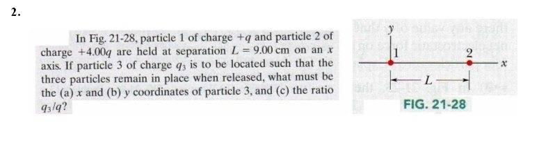

I also have another question I am not too sure about.
(Click on the attachment for question and diagram)
In this next question I am guessing because the length between particle 1 and 2 is 9.00cm that particle 3 will have to be located above the two points giving an equilaterial triangle.
From this we know all the sides will be the same length of 9.00cm with an angle of 60 degrees. However, there is no solid value given for the charge on particle 1 and 2.
Since
Q1 has a charge of +Q
Q2 has a charge of +4.00Q
So does this mean that the above forumula has to be arranged somehow,
for F3,1 and F3,2 ?

  • #32
learningphysics said:
what is the direction of the force that 2 exerts on 3? just generally.. don't use numbers... is it to the left or to the right? is it upwards or downwards?
The force that 2 exerts on 3 would be going downwards torwards the left?
  • #33
Q2 and Q3 have opposite signs right? So they will attract... so the force on 3 due to 2 is upwards and to the right.
  • #34
Ok I understand that, so that makes the answer possitve.
  • #35
Can't be a triangle because. The 4.00q force only exerts a horizontal force on the q charge. Now placing the 3rd charge above or below the x-axis means that the net force on the q charge will have a nonzero y-component. The same thing with the net force on the 4.00q charge.
So the third charge needs to be placed on the x-axis.
