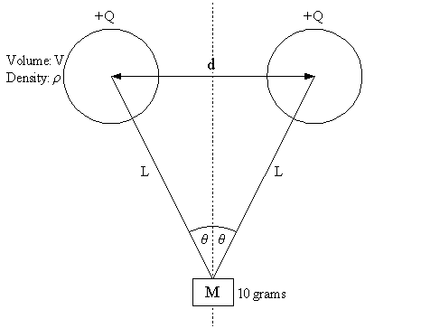

In summary: I'm not sure. I'm sorry if this question is worded strangely, it was translated from my homework which is in French.In summary, the balloons are pushed up by the electric force acting on the object.
Gazaueli
An object with a small mass (m) causes two balloons to float (neither ascending nor descending) in the air at a fixed distance from each other, as shown in the diagram. The balloons, with a volume (V) each carry a positive charge, Q. The balloons are said to be point charges, and their mass is not considered.
1. Create a diagram of all the forces at work.
2. Give a literal expression for the angle θ according to m, g, p, and V (study the condition of flotation, and do not consider Archimede's Principle exercised on the mass (m)).
3. By supposing that m=10g, L=1.5m, and d=30cm, calculate Q.

1. For the drawing of the diagram, and the figure from the problem, please see the attached photo.

Is the diagram upside-down? If the balloons allow the mass to float, I would expect that the baloons are above the mass. It's like a hot-air balloon - you don't put the gondola on top.

Cancelling forces are a good approach, but the balloons do not have a mass, therefore they have no gravitational force. How do balloons work (what is pushing them up)?
You can consider horizontal and vertical forces separately, both have to cancel. Can you split the tension into a horizontal and vertical component with trigonometry?
Which forces act on the mass?
No, the diagram is not upside down. That's exactly as it appears in the problem. From what I understand it's the mass that causes the two balloons to float up. It's lifted upwards from the bottom towards the two balloons thus causing them to lift and float.
No, that does not make sense.
I believe they're being pushed up by the charge on the object which is lifted towards them, no?
Only the balloons are charged, and their Coulomb force is purely horizontal.
Did you consider buoyancy?

The problem only makes sense if the mass is suspended below the balloons. Nowhere does the problem state that there is a charge on the mass, or that it is lifted to some position between the balloons. If that were the case the actual mass of the object would be irrelevant. Without a load to balance the buoyancy of the balloons there could be no equilibrium established.
So. The most likely setup implied by the problem description would be:
Another issue is that the problem doesn't adequately explain all the variables. In particular, when it says "Give a literal expression for the angle θ according to m, g, p, and V", what is p? The other variables m, g, and V are pretty standard designators of mass, gravitational acceleration, and Volume. But lower-case p is not so well established as a particular item. Could it be that it was meant to be ##\rho## for density of the balloons?

Gazaueli said:
Hmm, I don't understand why that wouldn't make sense. It clearly states in the questions that the small object causes the two balloons to float. Why isn't it considered in this problem? I thought it was only the masses of the balloons that are ignored here.
Without the mass, the balloons would rise upwards, as they have no mass on their own, but displace air.
No, I didn't. Would I then need to use Archimedes' Principle? If so, how would I apply it to this problem? I really don't understand the connection between electrostatics and buoyancy.
Right.
There is no direct connection between those concepts, they are just both sources of forces on the balloons.
