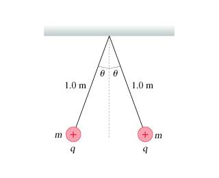

Two m = 6.0g point charges on 1.0-m-long threads repel each other after being charged to q = 120nC , as shown in the figure.
What is the angle θ? You can assume that θ is a small angle.
Hopefully the image will work.
I feel like something is missing. I've gotten 7.4 and 3.4 degrees - both wrong. I know the sum of the forces in all directions must equal zero. My equations then are:
Fx = -Tsinθ+Felectric
Fy = Tcosθ - mg
We know m, g, and q. I know that coulomb's law is:
F = Kq^2/r^2 ... but we don't know r.
Any ideas?
You are given the length of the string and the angle. Do you see a right triangle you could make in order to determine r?
Ah, yes ... a little clearer now.
So sinθ = r/1 = r. Alright let me run with that. Let's see if I can get it now.
Thanks for the nudge!
Wait! Are you sure ##\sin{\theta}=r##? Remember ##r## is the distance between the charges...
When I replied, I realized I made a mistake, like you said. It's not r, but rather r/2!
I was able to boil down the equation to:
(sinθ)^2*(tanθ) = kq^2/(4mg)
I'm pretty sure you can't boil it down anymore than that, so I used my old grapher to find the intersection point between both sides.
Got it!
Thanks a ton Zeta! I appreciate the insight!

You can actually do it withOUT using a graph. Note the hint: you may assume that the angle is small. In that approximation, what can you say about ## \tan \theta ## and ##\sin \theta ## ?
