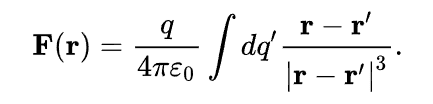

Su6had1p said:
what did I get wrong
Coulomb's law ?
Likes nasu and Orodruin

BvU said:
ok, lets apply this formula!
what does it change ?
as far my thinking goes-
this integral simply adds up the product of elemental charges with the function next to them, now take for instance this ##\rho(r')## describes charge density for a sphere of radius ##R##. Now in the interior of the sphere suppose at an arbitrary distance ##r<R##, we wish to evaluate the integral, wouldn't that mean ##r'=r## ? But then we run into another problem...

You aren't wrong. If you feel up to it, write down Coulomb's law integrand, just the integrand.
