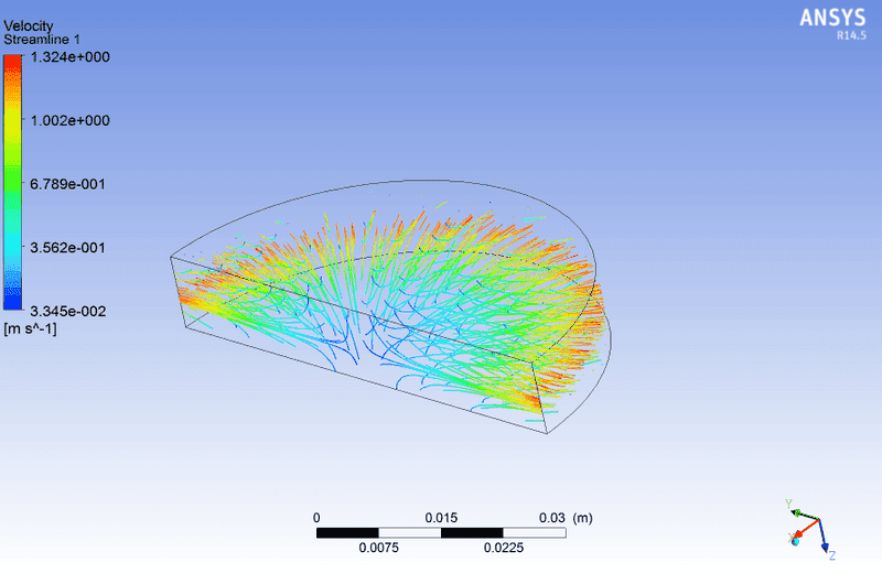

My PDF table seems OK as The plots show a max temperature of 1800 K at a mean mixture fraction value of 0.1. The geometry is a simple cylinder with two inlets in the axial direction and outlet in radial direction(image).
The Dia of two inlets is 60mm and the gap=10mm.

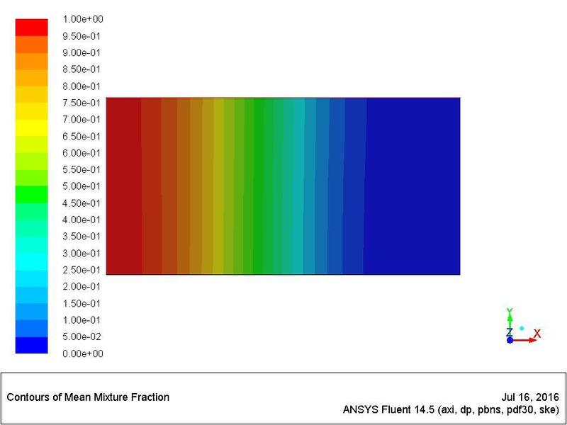

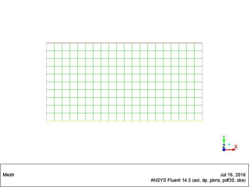

OK, if you simulate a 2D axially symmetric case, can you show your mesh and a contour plot of the mixture fraction?
Can you explain to me what adiabatic means? It is very important to know and I think you do not fully understand it.
These are the images you asked for.
I suppose adiabatic is a condition where we do not have heat exchange between system and surroundings.The mesh has two inlets on left and right, an outlet at the top and axis a the bottom. There are no walls which eventually means I have no place to define heat transfer coefficients.

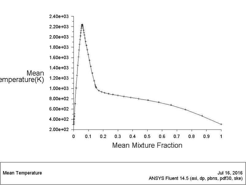

OK, that is clear. Let's go to the next step in the analysis. Let's compare the values from the lookup table with the values from the simulation.
Can you make a graph of the temperature as a function of the mixture fraction from your pdf lookup table (for mixture fraction variance 0)?
Can you also make a graph of the temperature and the mixture fraction as a function of x from your simulation results (for y=0)? Can you make another graph with 2 lines: mixture fraction as function of temperature from the pdf table and mixture fraction as function of temperature from the simulation data on the x-axis?
I hope this comparison will show you what is wrong with your simulation.
Indeed, in an adiabatic system there is no change in heat, do you see that adiabatic has nothing to do with if the process is instantaneous or not? An adiabatic flame is simply a flame where the total enthalpy of the gas is not changing. If there is radiation, or if there is a solid (a wall) that takes heat away from the flame, then the combustion is not adiabatic.

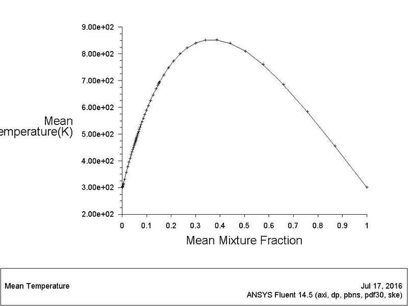

The PDF plot is a 2D plot (with constant Variance=0) on a 3D surface(with constant scalar dissipation=0).Maximum of Mean Temperature(K) is 2.240994e+03 and occurs at Mean Mixture Fraction = 5.683755e-02.

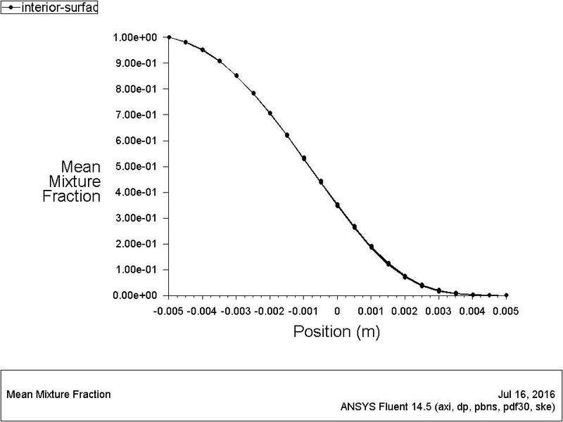

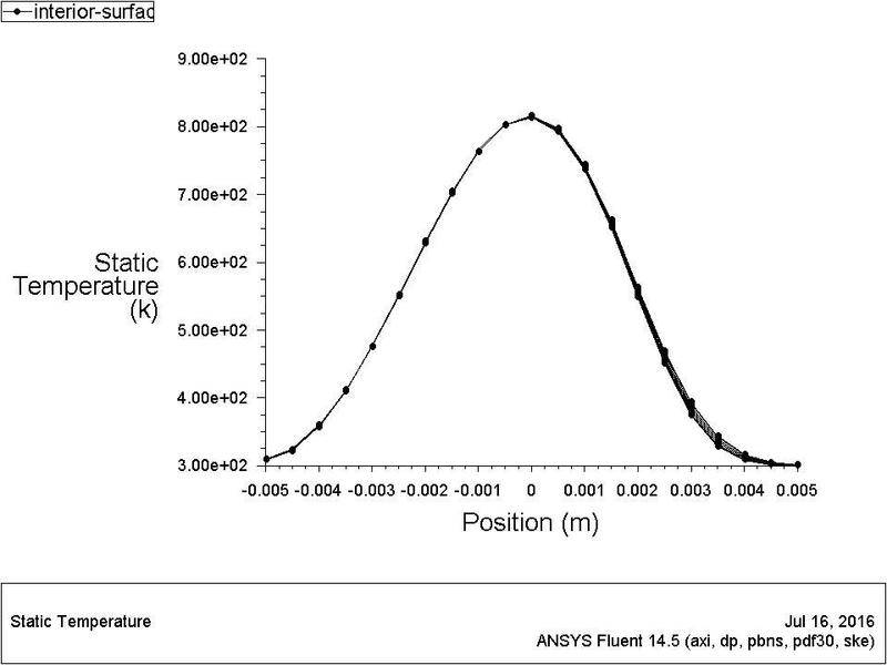

Below are the images from simulation results as functions of x.
Should I activate the energy equation and the radiation models? Also I could not plot the last Image with two curves as I don't know how to.
Well, it is clear that this lookup table is not the one that is being accessed to obtain the temperature. Does your pdf table contain laminar flamelets for different mixture fraction variances? Can you visualize the mixture fraction variance in your domain?

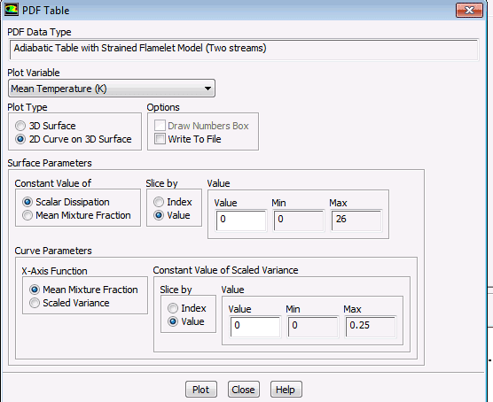

Yes, my pdf table contains flamelets for different mixture fraction variances. Below is an image of the PDF table. I hope it would help.

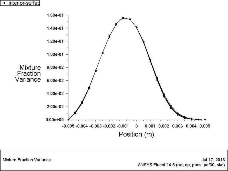

Scalar dissipation varies from 0-26 and the scaled variance varies from 0-0.25 .Following is a curve for the mixture fraction variance in the domain.

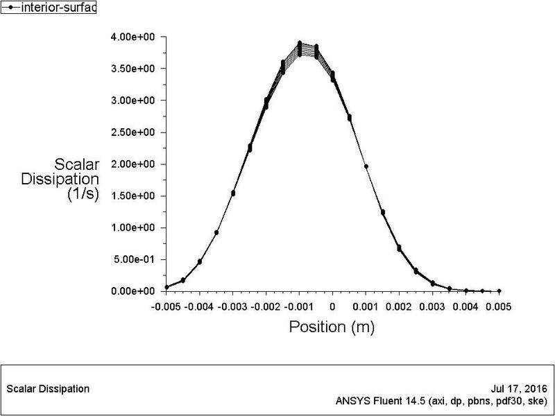

Following is an image of scalar dissipation in the domain.
From the above data, I conclude that my domain has a max deviation of 0.15 and a max scalar dissipation of 4 and both of them peak near the zone where I am getting max temperature(850K). So I decided to make another temperature plot from PDF table keeping the value of dissipation=4 and variance =0.15.
Following is what I get.
The above graph peaks around 850K(approximately around my flame temperature).

Your variance and scalar dissipation rate in your simulation are very high and this causes the temperature to drop. fluctuations increase due to turbulence, so you should try to lower the turbulence levels in your simulation. You could do the following:
- Lower the velocity of the streams to reduce the Reynolds number of your setup.
- Check what turbulence boundary conditions you are using. you could set them at constant k and epsilon and give a very low value for k (k=0.001) and a value for epsilon e=1. From your plots I gather that your mixture fraction variance is already set to zero at the boundaries?
