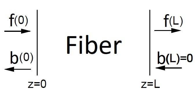

It is getting closer to the answer but it still doesn't agree with the correct solution posted above. Any ideas what could be wrong here?
Also, how would it be possible to factor ##L## into the solutions? It represents the fiber length, such that ##b(L)=0##. I have made a diagram of the geometry of the problem:
You also have a condition for ##b(L)##. You should be able to use that condition to fix ##b(0)## in terms of ##f(0)##.

Due to the geometry of the problem ##b(L)=0##, so I tried to write ##b(0)## in terms of ##f(0)##:

As pointed out in #10, you need to express b(0) in terms of f(0) by setting b(L) = 0. Then, to simplify further, use the "addition" laws
$$\begin{array}{l}\cosh(u-v) = \cosh(u) \cosh(v) - \sinh(u) \sinh(v)\\
\sinh(u-v) = \sinh(u) \cosh(v) - \cosh(u) \sinh(v)
\end{array}
When I did it I got exactly eq (1.1), eventually.
Likes roam
Thank you very much, Ray Vickson and Orodruin. I really appreciate your time. I got the correct answer too (it makes perfect sense now).
