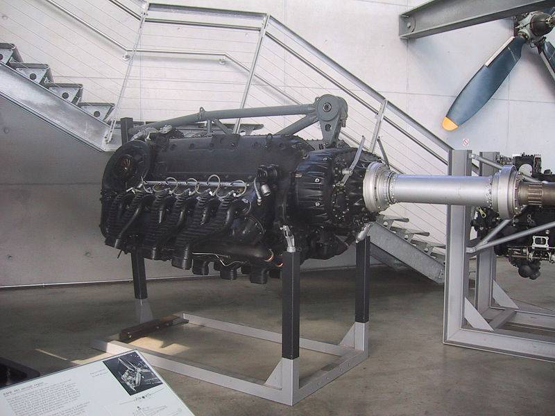

DB610 engine used a common crankcase for two db605 engines with a gear drive linking both of the crankshafts to a common output shaft.

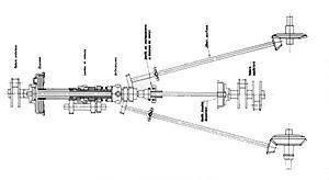

The "pogo" used two engines linked by a gearbox called the allison t40.

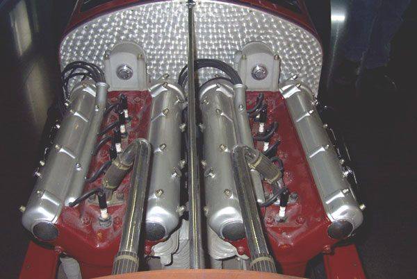

Bugatti P100 racer...who's image is linked because of it's size.
http://sobchak.files.wordpress.com/2009/11/bugatti100cut.jpg

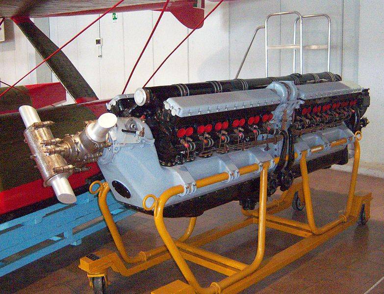

Fiat engine...a true engineering masterpiece in that the engines were run "back to back" among onther brilliant ideas.
as used in the airplane that still holds the record for fastest piston engine seaplane...and most other piston engine planes save for a few.
[PLAIN]http://upload.wikimedia.org/wikipedia/en/c/cf/Macchi_M.C.72.jpg
