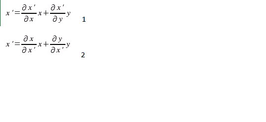

Hey all, I've just started tensor analysis but do not understand why in contravarient uses 1 and covarient uses 2, could someone please explain these? Perhaps my understanding of the definitions is causing me to misunderstand why its written like this. Any help appreciated.
Can you explain your notation? What are "x',y',x,y" supposed to be in this picture?
"The components of a vector in two dimensions are defined in the literature in relation to a change of coordinates from (x,y) to (x',y'), say. The contravariant components are those which transform as follows e.g. for the new coordinate x' in terms of the old (x,y):"
That is some seriously confusing notation. What book is this?
A change of coordinates from (x,y) to (x',y') looks simply like ##x'=x'(x,y),~y'=y'(x,y)## so these are simply functions of the old coordinates. Vector and one form components transform similarly to the picture you uploaded, but I've never seen that kind of notation. Usually the notation is such that for a vector: $$V^{\alpha'} = \sum_\beta \frac{\partial x^{\alpha'}}{\partial x^\beta} V^\beta$$ And for a one form: $$\omega_{\alpha'}=\sum_\beta \frac{\partial x^\beta}{\partial x^{\alpha'}}\omega_\beta$$
Those equations and the corresponding ones for y' define covariant and contravariant in this (obsolete and horrible) approach to tensors, so it's a bit odd to ask why the equations look the way they do. It does however make sense to ask why those terms are used. The idea is that in the covariant case, the matrix that transforms ##\begin{pmatrix}x\\ y\end{pmatrix}## to ##\begin{pmatrix}x'\\ y'\end{pmatrix}## is the same matrix that transforms the basis vectors (hence the term covariant), and in the contravariant case, the matrix that does the transformation is the inverse of the matrix that transforms the basis vectors (hence the term contravariant).
The modern approach starts with a vector space V. Its dual space V* is defined as the vector space of linear maps from V into ℝ. Now suppose that ##(e_1,\dots,e_n)## and ##(e_1',\dots,e_n')## are ordered bases for V. There must exist numbers ##M^j_i## such that ##e_i'=M^j_i e_j## (each of the primed basis vectors can be expressed as a linear combination of the unprimed basis vectors). Now we can examine the relationship between the components of an arbitrary ##v\in V## with respect to these two ordered bases. It turns out that it's given by ##v^i{}'=(M^{-1})^i_j v^j##. Because of this, the n-tuple of components is said to "transform contravariantly".

There's a simple way to use an ordered basis for V to define an ordered basis for V*. Because of this, it makes sense to ask for the relationship between the components of an arbitrary ##f\in V^*## with respect to the two ordered basis for ##V^*## that are defined from the two ordered bases for ##V## mentioned above. It turns out that the relationship is given by ##f_i'=M_i^j f_j##. Because of this, the n-tuple of components is said to "transform covariantly".

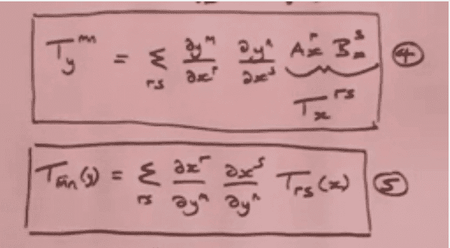

Confusion, in the video teaching me this they say that
equation 4 is the contravarient one and that equation 5 (the inverse) is the covariant one, your intuition made sense but this confused me now, his notation isn't helping.

See post #4, "contra variant vector" is the old term for "vector" and "co variant vector" is the old term for "one form". Contra variant tensors have indices up and co variant tensors have indices down.
In my notation, the first one is ##T_y^{mn}=(M^{-1})^m{}_r(M^{-1})^n{}_s T_x^{rs}## and the second one is ##T_{mn}(y)=M^r{}_m M^s{}_n T_{rs}(x)##.
