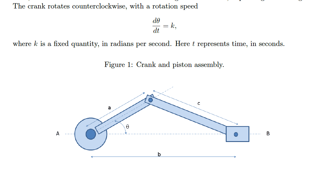

Hi,
Looking for some help on a crank/piston motion equation..
If a crank rotates counter clockwise measured in Radians/sec -as d\theta/dt = K T = time in secs
The arms of the crank A and B are fixed and B is the stroke length with \theta as the angle between A and B
So far I've got that B = Acos\theta + \sqrt{C^2 -(Asin\theta)^2}
Min/max for B is at \theta = 0, Pi, 2Pi.
Q. What is the relationship between dB/dt and dB/d\theta -
A. is this that dB/dT = d\theta/dT x dB/d\theta?
Q. obtain a formula for dB/dT. Answer should be in terms of A, C, \theta and K
A. dB/d\theta = -Asin\theta+ A^2sin\thetacos\theta/\sqrt{C^2 -(Asin\theta)^2}
So my question is dB/dt then simply the the above formula for dB/d\theta x K
=K(-Asin\theta+ A^2sin\thetacos\theta/\sqrt{C^2 -(Asin\theta)^2})
Q. Obtain a formula for d^2B/dT^2
A. if K is constant is that then second derivative of B x K
= B".K
Haven't got to working out the second derivative of B just yet,
any advice appreciated
Thanks
TomView attachment 6151

Hello Tom,
I think what I would do here is first use the Law of Cosines to determine $b$:
\(\displaystyle c^2=a^2+b^2-2ab\cos(\theta)\)
Arrange in standard quadratic form:
\(\displaystyle b^2-2a\cos(\theta)b+a^2-c^2=0\)
Apply the quadratic formula, and discard the negative root (since we must have $c>a$):
\(\displaystyle b=\frac{2a\cos(\theta)+\sqrt{4a^2\cos^2(\theta)+4(c^2-a^2)}}{2}=a\cos(\theta)+\sqrt{c^2-a^2\sin^2(\theta)}\)
This agrees with your result.
Q. What is the relationship between \(\displaystyle \d{b}{t}\) and \(\displaystyle \d{b}{\theta}\)?
Using the chain rule, we may state:
\(\displaystyle \d{b}{t}=\d{b}{\theta}\cdot\d{\theta}{t}\)
We are given:
\(\displaystyle \d{\theta}{t}=k\)
Therefore, we obtain:
\(\displaystyle \d{b}{t}=k\d{b}{\theta}\)
This is where you were headed, but you didn't make the substitution for $k$.
Q. Obtain a formula for \(\displaystyle \d{b}{t}\). Answer should be in terms of $a$, $c$, $\theta$ and $k$.
Okay, given that we found:
\(\displaystyle b(\theta)=a\cos(\theta)+\sqrt{c^2-a^2\sin^2(\theta)}\)
Differentiating w.r.t $\theta$, there results:
\(\displaystyle \d{b}{\theta}=-a\sin(\theta)+\frac{1}{2}(c^2-a^2\sin^2(\theta))^{-\frac{1}{2}}(-2a^2\sin(\theta)\cos(\theta))=-a\sin(\theta)\left(1+\frac{a\cos(\theta)}{\sqrt{c^2-a^2\sin^2(\theta)}}\right)\)
And so, using our result from the first question, we have:
\(\displaystyle \d{b}{t}=-ak\sin(\theta)\left(1+\frac{a\cos(\theta)}{\sqrt{c^2-a^2\sin^2(\theta)}}\right)\)
Now, before we move on to the final question, we can observe that our computation will be simpler if we write:
\(\displaystyle \d{b}{t}=\frac{abk\sin(\theta)}{a\cos(\theta)-b}\)
Now we may apply the quotient and chain rules as appropriate. :D
Hi Thanks for the help, glad to see I wasn't too far off.
One thing for the formula for B, i reached the formula by creating 'h' to represent the height of the joint of A+C, and then split B in B1 and B2 at h to create to right angle triangles.
B=B1 + B2
B1 = Acos\theta
B2 = \sqrt{C^2 -h^2}
h = Asin\theta
B2 =\sqrt{C^2 -(Asin\theta)^2}
b = Acos\theta +\sqrt{C^2 -(Asin\theta)^2}

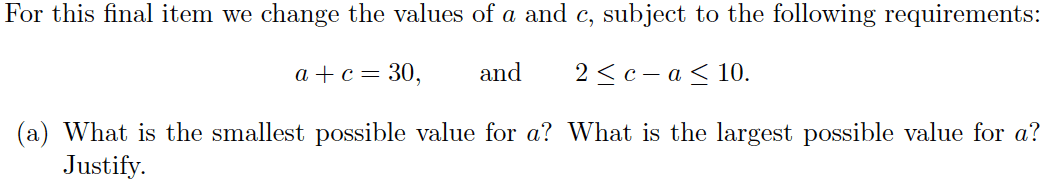

Hi, Also need some help on a following question to this same problem.
need work on optimisation for the values of A+B
I tried optimising by implicit differentiation of a right and angled triangle, however the values I get are out side of the given range
12. we change the values of a and c, subject to the following requirements:
a + c = 30; and 2\le  c- 􀀀 \lea  10:
(a) What is the smallest possible value for a? What is the largest possible value for a?
Justify.
What is this line supposed to say?
tomc612 said:
...a + c = 30; and 2\le  c- 􀀀 \lea  10:...
Sorry, the question should read:
Okay, we are given:
\(\displaystyle c=30-a\)
And:
\(\displaystyle 2\le c-a\le10\)
Substitute for $c$:
\(\displaystyle 2\le 30-a-a\le10\)
Simplify:
\(\displaystyle 2\le 30-2a\le10\)
You should be able to algebraically show this is equivalent to:
\(\displaystyle 10\le a\le14\)
