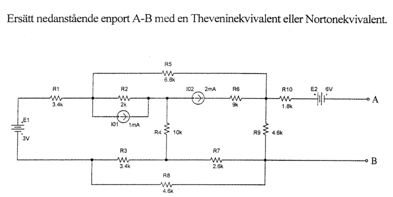

Replace the circuit A-B with a theveninequivalent.
Hey, I am having big issues with the following question. I have done node analysis to get the following equations 1-5 and the equation for A i have removed because it was not needed apparently. When solving the equationsystem I get that the voltage in node 1-5 is (using matlab)

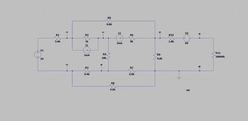

Thanks for the response! I got the real answers using multisim:
--- Operating Point ---
V(n001): 0.683191 voltage
V(3): -2.31681 voltage
V(2): -2.01304 voltage
V(1): -3.56637 voltage
V(4): -1.333 voltage
V(5): 4.6758 voltage
V(n002): 22.6758 voltage
V(n003): 4.67604 voltage
I see that I have written a R2 instead of R10, but I have used R10 when I have made my calculations. Does the calculations and equationsystem look correct though?

The circuit you solved with multisim has a 10000k resistor, R11, that your circuit in post #1 does not have. If you include that resistor you will get the same result as multisim:
Ohhh I did not know that R11 affected the results, only used it for easier simulation. I am so thankful for the help, I have been stuck on this assignment very long! So now to get the open circuit voltage I have to take U0=VA-VB=VA-0=VA=V5-E2=5,53088-6,00000=-1,3242 voltage. And to get the short-circuit current I take I0=(V5-E2-0)/R10=(5,53088-6,00000)/1800=-0,2606...mA?
