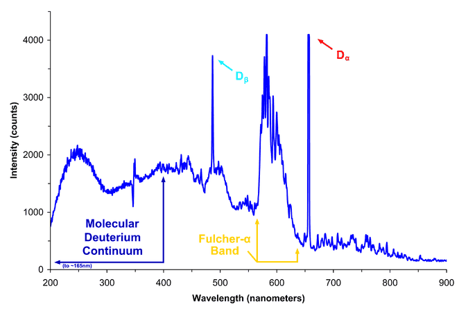

A broad spectrum LED and the xenon/deuterium lamp both have fairly discrete or peaky spectra. How continuous and smooth do you want this source to be?
https://en.wikipedia.org/wiki/Deuterium_arc_lamp
