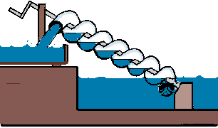

I think you're just referring to a conventional pump like this one:

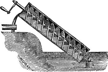

As opposed to the Archamedes screw concept:

Yes, the picture of the conventional pump is correct. If no pressure is applied to the crank, and water can flow in at the top, it will turn like an engine.

I guess I'm still not following you. There are water pumps driven by solar power. Pumps can even be driven by flowing water. The energy available from water flowing from one height to another is dictated by Bernoulli's equation. The amount of energy required to raise water from one level (A) to another (B) is equal to the amount of energy gained from lowering the same amount of water between those two levels. But there's always some frictional forces that also have to be overcome so the amount of energy put into raise water from A to B is always slightly greater than the energy that can be extracted from lowering the same amount of water the same height.
Perhaps your question is whether or not one of the Archimedes screw type pumps is more efficient than something like a centrifugal pump. That I don't know. A centrifugal pump can be very efficient. There's a huge variety of pump types on the market and the Archimedes screw types are also found in industry, so clearly there's an application for them. What you'll find is that various pump designs lend themselves to certain applications. For example, reciprocating machines often find a niche in applications that require very high pressure but at relatively low flow. Those machines can have a very high efficiency but they are typically more expensive than a multi-stage centrifugal type. An Archimedes screw might be more competitive with centrifugal machines for very low pressure applications. The type of pump is dictated by the economics of capital cost, energy cost and maintenance cost.
If you look at the center of gravity for each pocket of captured water, you will find that it is off center from the shaft. The eccentricity will cause a torque to the shaft that must be overcome just to hold the pipe screw stationary. As soon as you turn the crank to raise the pockets of water, you exert increased torque on the shaft. Now with the water moving upward, you are performing work which requires an energy supply to perform it. Since the water is in a tube, it will have a friction component to it as it slides along, thus increasing your energy requirement. So ultimately, you don't have the situation you thought you would in your problem statement.

"The eccentricity will cause a torque to the shaft that must be overcome just to hold the pipe screw stationary."
That about says it; I knew it would run the machine in reverse, but didn't think of it as an energy requirement, as well. I guess I'd better turn elsewhere for my contribution to irrigation, though the fact that an Archimedes pump will pump water at minimal speeds and therefore minimal energy input, means that it could be used in situations where energy is limited to non-internal combustion engines, like windmills at low wind speeds and solar energy during the winter months. Coupled with drip-irrigation, it still might be a great alternative in dry, rugged, mountainous areas where water may be captured from distant winter snow-pack melt and mountain thunderstorms.
