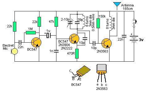

hi there,
It appears as tho you have a bad misunderstanding of what digital and analog is
Pretty much any transmitter from oscillator to final amplifier is an analog circuit
what makes it a digital or analog transmitter is the modulation type applied to it
just for an example ... here's a basic 3 transistor ANALOG FM transmitter

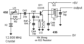

here's a basic single transistor Colpitts Oscillator running at ~ 12MHz Also ANALOG
Dave
EDIT ... got home and discovered the Colpitts osc diag wasnt there

The 3 transistor circuit above would fit the bill - analog mic input and crank-cap tuning, the only arguably digital component is the switch - and so would many others circuits easily googleable so I still wonder what OP actually wants. You know - to narrow it down a bit?
