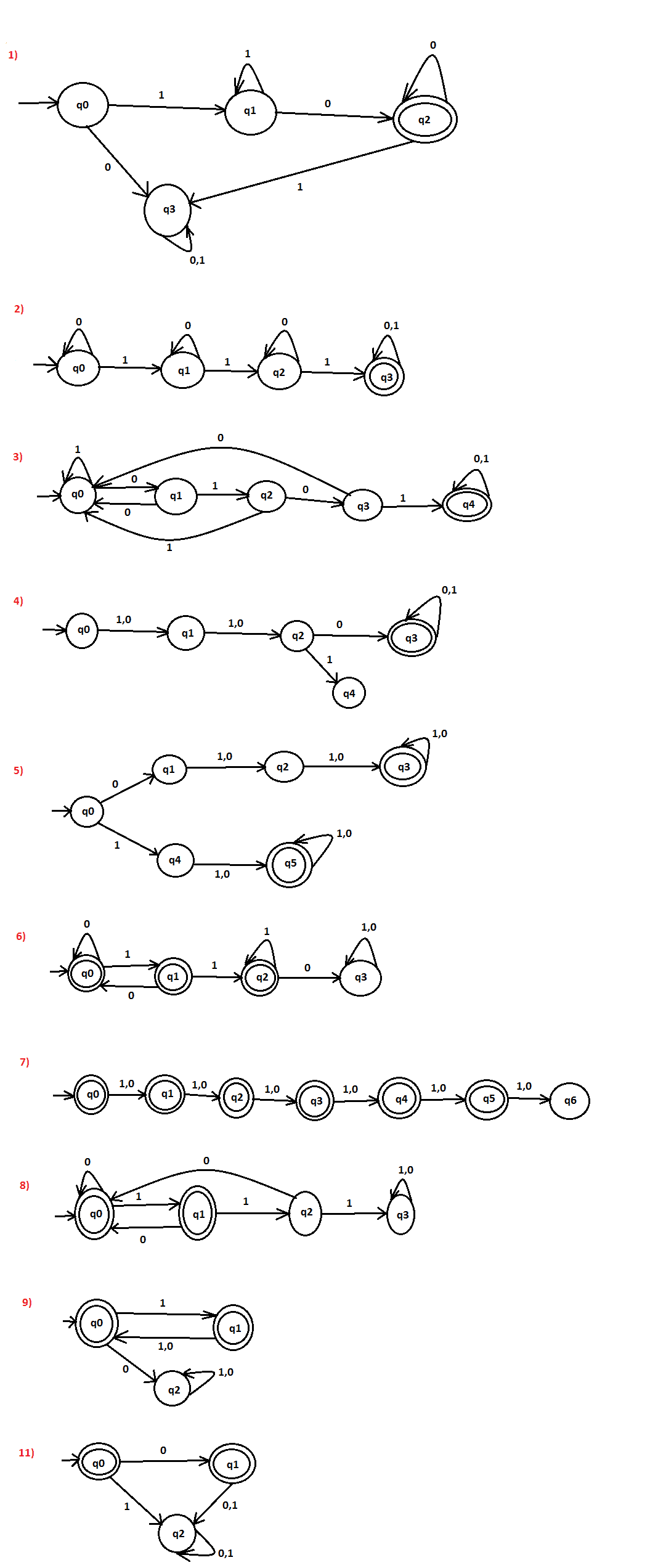

I have to draw the DFA's for the following languages:
$\Sigma=\{0, 1\}$
  1. $$\{w \mid w \text{ starts with } 1 \text{ and ends with } 0 \}$$
  2. $$\{w \mid w \text{ contains at least 3 } 1\}$$
  3. $$\{w \mid w \text{ contains the substring } 0101\}$$
  4. $$\{w \mid w \text{ has length at least } 3 \text{ and the third symbol is } 0\}$$
  5. $$\{w \mid w \text{ starts with } 0 \text{ and has an odd length, or with } 1 \text{ and has an even length} \}$$
  6. $$\{w \mid w \text{ doesn't contain the substring } 110\}$$
  7. $$\{w \mid \text{ the length of } w \text{ is smaller than or equal to } 5\}$$
  8. $$\{w \mid w \text{ is any string besides } 11 \text{ and } 111\}$$
  9. $$\{w \mid \text{ in each odd position of } w \text{ there is a } 1\}$$
  10. $$\{w \mid w \text{ contains at least two } 0 \text{ and at most one } 1\}$$
  11. $$\{\epsilon , 0\}$$
  12. $$\{w \mid w \text{ contains an even number of } 0, \text{ or exactly two } 1\}$$
  13. the empty set
  14. all strings besides the empty one.
I have done the following:
Could you tell me if it is correct?? (Wondering)
Could you give me some hints how we could find the DFA of the last three languages ?? (Wondering)

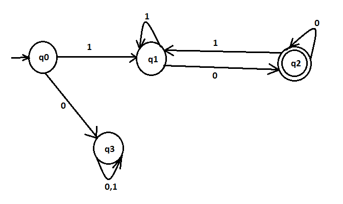

Hey mathmari! (Wave)
I'll just pick up number 1 for now: w starts with 1 and ends with 0.
Hmm... so 1010 would be part of the language wouldn't it? (Thinking)
Does your DFA accept 1010? (Wondering)
It doesn't accept 1010... (Headbang)
Should it be maybe as followed?? (Wondering)
Or have I done something wrong?? (Wondering)
No worries. That's it. (Nod)
Number 2 looks fine to me. (Happy)
