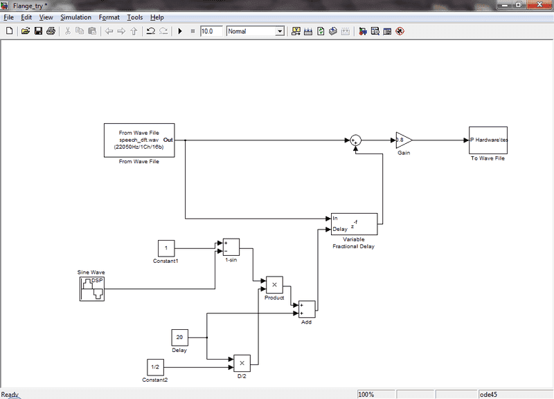

Im trying to model this in simulink. I am having a little trouble getting things to work. I need to create a variable delay model or basically implement a "flanger" effect.

So this is what I have right now.

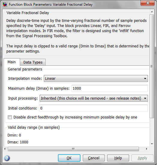

The parameters of the Variable fractional delay block are here:
Im basically trying to mimic that equation with math operators. I am told that it should do the trick. However it doesn't. I am not sure where I am going wrong. Any hints or tips would be greatly appreciated!
Thank you,
E

I do not have much experience with simulink, but it seems to me that your model should work.
What does it do now?
Or what exactly doesn't it do?
